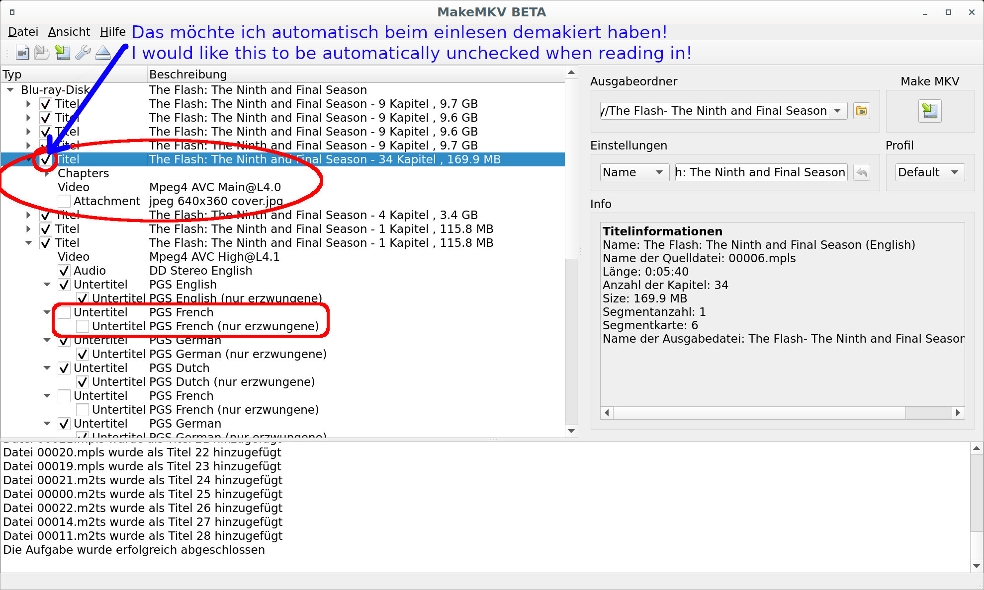

Hello everyone,
Is there a way to remove all tracks that have NO audio? I've already tried a few options.
I tried it with:
"-sel:video&!audio"
"-sel:video&(!audio)"
"+sel:(favlang&audio|nolang&audio)"
"+sel:(favlang&(audio)|nolang&(audio))"
all without success, the tracks with video but without audio were still marked
I want all the tracks, but the ones WITHOUT audio deselected. Is that even possible?
To test whether the Advanced option is even taken into account, I simply left "-sel:all" in, but all tracks were still marked!?!
It seems to me that the advanced options are not taken into account at all.
However, if I enter "-sel:all,+sel:(ger|eng|dut)," exactly those audio and subtitles are highlighted, and French, for example, is deselected. So, it is still taken into account.

The software creates MKV files therefore it must contain video. The main video track cannot be deselected.

MartyMcNuts wrote:
Tue May 13, 2025 12:04 am
Hi, and thanks for your answer, but you misunderstand me. I don't want to remove the video from the MKV file. Rather, I don't want to have this track selected for MKV creation at all and I want to have the checkbox unchecked! This means that no MKV should be created from it if there's no audio in the track.
