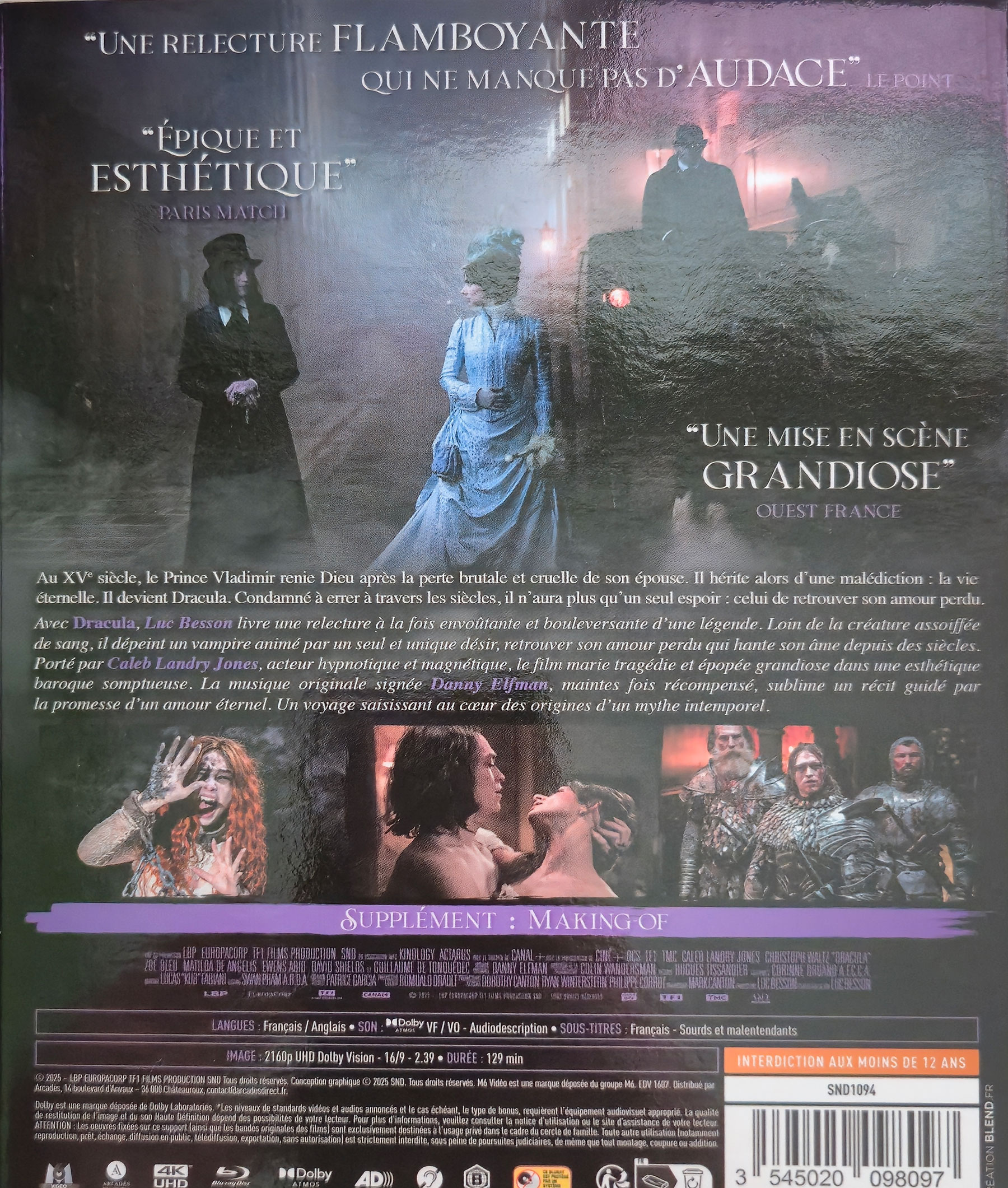

It's French edition of Dracula.
I thought that the HDR was a part of UHD, I mean, that it is required...Am I wrong here? Anyway, the DV is there on the box.

I don't have that one in my collection. I believe you that the box suggests it has Dolby Vision. I was unable to find a picture of the back of the case on the internet. The few French sites I've found talking about the movie contradict one another about if the movie has any HDR or not.
https://4k-ultra-hd.fr/film/dracula-4k-2
That site seems to suggest that it does not have any HDR. But others have said that it does.
As I understand it, a UHD does not require HDR content. It certainly supports it however. I think it does require things to be in a wider colorspace, Rec. 2020, which is a bigger colorspace than Rec. 709 used on regular blu-rays. Having a wider color gamut is not the same thing as having high dynamic range however.

Interesting...I was convinced that the UHD standard required HDR to be present. I wonder where I got that from...
Anyway, I made a photo of the back of the box for future reference, if someone would need it.
