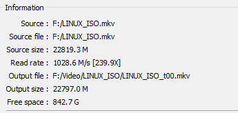

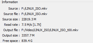

This is processing the same file with the different versions.
v1.17.8 it's processing at ~7.8 M/s [1.8x], it will take 48+ minutes (didn't want to wait for it to finish)
v1.17.6 is processing at 1028 M/s [239.9x], finishes in 23 seconds.
Not sure what is going on with v1.17.8 but it's the first time I've see this weirdness in many many years of using this excellent software.
