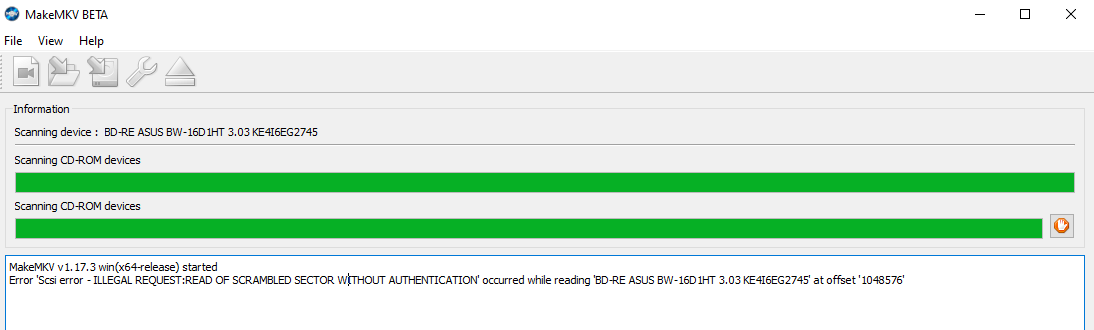

Hi All,
Never had this message come up before. Any idea's on how to fix?
Tony

Re: Error Message
Usually it's really, really hard to fix - clean the disk.
Posts: 4468
Re: Error Message
I get that error message with every DVD I put in my drive… and then everything works normally. I do NOT get that error with blu-rays or UHDs.

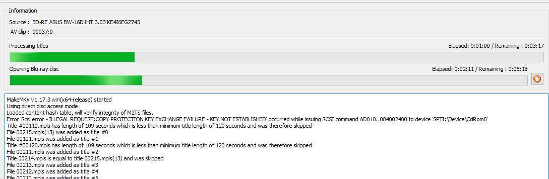

Interesting. Threw a bluray in there and it pushed through the error message. Seems to just be any DVD.
I just don't understand it was fine last week? :( What a pain in the arse.

Re: Error Message
Post by bmillham »
It could be the the DVD laser has died so only BD and UHD disks will work with that drive. Or, is the drive in an external enclosure? I have a drive that when used internally works fine for DVD/BD/UHD but when in an external enclosure DVD will not work.
