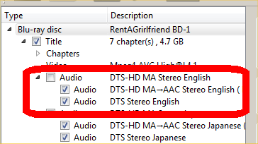

You can play with the capabilities within MakeMKV by making sure you have Expert Mode enabled, and selecting either the FLAC or AAC profiles on the advanced tab that will appear. This is how the available selections change when using the "aac-stereo" profile, for example:
In this case, it can convert an DTS-HD MA into an AAC stereo track. The original DTS-HD MA track is also available to be selected.

Re: MakeMKV and Stereo Audio
In the example, the original audio is the DTS-HD MA track; the indented options are derivations from it. The --> indicates a conversion, while the "DTS Stereo" is the base lossy core.
MakeMKV defaults to extracting "lossy core" audio from lossless audio tracks, for compatibility. For TrueHD, it will pull out the AC3 core by default.
As for the title, that was handy to make the snapshot. I was going to use something with LPCM, but didn't feel like unwrapping Irregular at Magic High Visitor Arc again. Haven't had time to watch the anime yet...

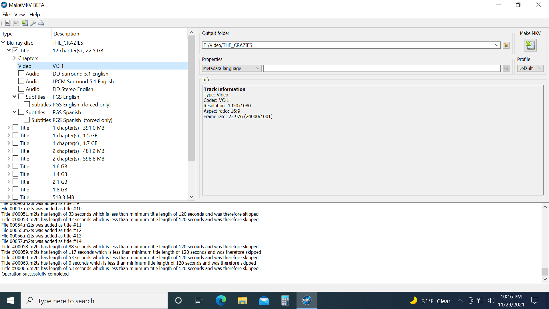

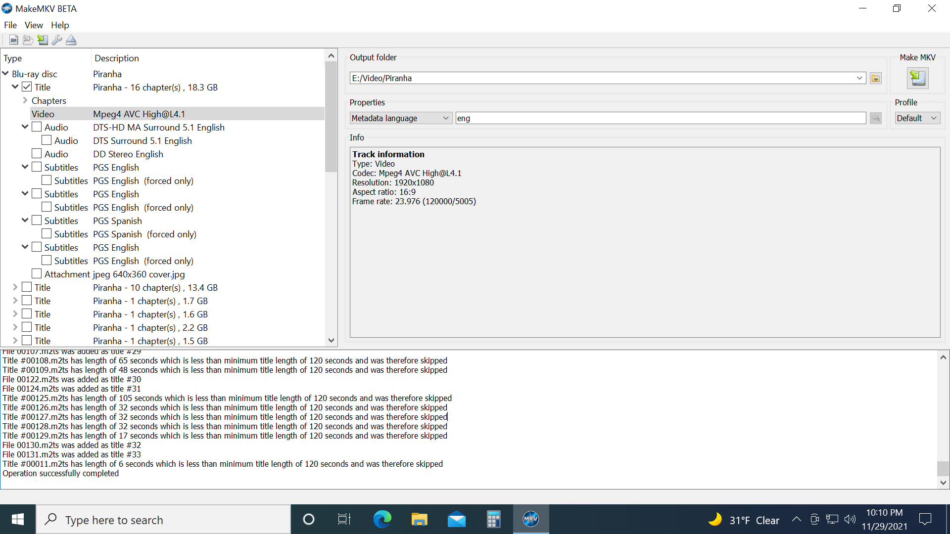

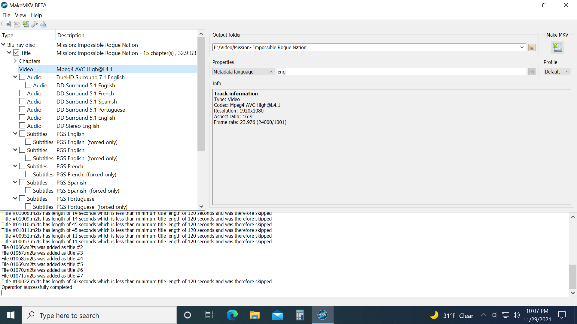

Here are a few screenshots with different audio options.
DTS-HD MA Surround 5.1 (This is the top/first option in one example)
TrueHD Surround 7.1 (This is the top/first option in one example)
DD Surround 5.1 (This is the top/first option in one example)
DD Stereo (This is an option in each example)
I ripped all my Blu Rays using the top/first audio option. I guess this was wrong for someone with a stereo audio system. I probably should re-rip all my Blu Rays using the DD Stereo audio option. I didn't even realize that I had a stereo option the whole time.
How does DD Stereo compare in quality with DTS-HD MA Surround 5.1, TrueHD Surround 7.1 and DD Surround 5.1? I realize one is stereo and the others are surround but is the DD stereo a reduced audio quality compared to the others?
Here are the examples,
In all of those cases, your selected profile was "default", which will not offer conversions to other formats.
If you select "flac", you will get options to convert each track to FLAC, as well as saving the original. The "aac-stereo" profile will offer a conversion to AAC, as in my example above.
Dolby Digital (DD) should play directly on a stereo receiver, even a 5.1 track version. The basis is a stereo track, after all.
