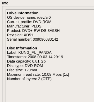

Is this the info you mention in the right-hand side?
I have also attached the debug log.

That is a VERY old drive... Assuming you want to do a lot of ripping, and upgrade to BD (or UHD) capability, replacing it would be in order.
Part of the speed issue is likely MakeMKV having to deal with the drive region setting. MakeMKV will not change the region setting on the drive, it will just try working around it if it is incorrect. Usually that works, sometimes it doesn't, depending on the disk being ripped.
And it seems there are some issues with the actual reading of the disk in question. Cleaning the disk will likely help, but the drive itself may need cleaning, too.
