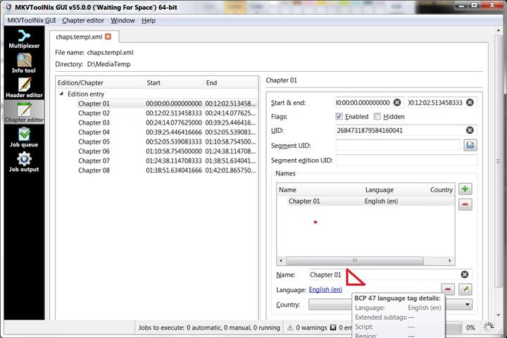

I think I found someone with a similar problem. They couldnt get the chapters to recognise on an Apple TV, the solution was that the chapter needs a language track in metadata which aparrently Handbrake doesnt supply...? I think the general view was that he needed to use a different package than Handbrake.
Posts: 1713
Re: Chapters not working after Handbrake?
Post by d00zah »
ben_uk wrote:
Tue Mar 09, 2021 8:38 pm
Pretty sure, chapter-wise, HandBrake just passes thru what was originally in the source, making this an Apple TV issue.
You can try the Chapter Editor in mkvtoolnix to "fix" a problem file... just select the Chapter Editor tab & drag the .mkv file into the window. Set the language attribute FOR EACH CHAPTER, select the Chapter Editor pull-down & select 'Save'. Does it fix Apple TV playback?
