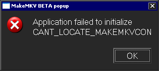

When you try to start the graphical user interface (makemkv.exe) then the program will tell you, that it can't find it's console application (makemkvcon.exe).

My analysis so far is, that makemkv.exe calls kernel32.dll/CreateNamedPipeW to open a connection with writing access to a pipe which is supposed to be connected with makemkvcon.exe. But the function fails with ERROR_INVALID_PARAMETER. Then makemkv.exe shows the error message and terminates itself afterwards.

Tried once more and I see, that my error message is a little bit different: NO_ANSWER_FROM_MAKEMKVCON. But it fails to initialiaze the application with just that window.

If I remember correctly there are 4 different error messages you can get at this stage of the loading process. They all seem to be triggered by a failed pipe connection in one way or another.
I tried to get version 1.16.0 running by either using makemkv.exe or makemkvcon.exe from the 1.15.4 package. This seemed to have revealed that the error is in makemkv.exe.
A comparision of the 1.15.4 makemkv.exe and the 1.16.0 makemkv.exe might reveal more. Especially if we look at the values of the input parameters that makemkv.exe feeds to kernel32.dll/CreateNamedPipeW.

On Windows XP Pro SP3, I got the same error message as Username1267.

Hurray, I got it running. A single bit was the cause. Setting the bit to 0 solves the problem.
I just checked the function call and what makemkv.exe is feeding as input parameter values:
call kernel32.dll/CreateNamedPipeW(
	Name = address_of_2_byte_per_character_string("\\.\pipe\LOCAL\makemkv-00000974-01")
	OpenMode = 0x40080002 (PIPE_ACCESS_OUTBOUND|FILE_FLAG_OVERLAPPED|WRITE_OWNER)
	PipeMode = 8 (PIPE_WAIT|PIPE_READMODE_BYTE|PIPE_TYPE_BYTE|8)
	MaxInstances = 1
	OutBufferSize = 0
	InBufferSize = 0
	DefaultTimeout = 0
	pSecurity = 12F6B0 -> {Length = 12|d, pSecurityDescriptor = NULL, InheritHandle = true}
The parameter "PipeMode" has an invalid value. 0x8 = PIPE_REJECT_REMOTE_CLIENTS is not supported in versions of Windows below 10.0 (at least not according to the official documentation).
