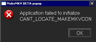

Hello and welcome to the scene,
as you probably noticed there is a new version out (1.16.0). This version has the same problem like the previous version (1.15.4), that it cannot be used in Windows XP anymore. The last known version which works out of the box in Windows XP is 1.15.3.
We got the previous version (1.15.4) working in Windows XP by replacing the libffm.dll with a hacked one (see separate forum topic). But the new version (1.16.0) does not need this hack because it has this issue fixed, but it has a different problem.
When you try to start the graphical user interface (makemkv.exe) then the program will tell you, that it can't find it's console application (makemkvcon.exe).
In the previous version (1.15.4) with no hack the console application (makemkvcon.exe) could not start and therefore you got an initialization error, too. But in the new version (1.16.0) the console application (makemkvcon.exe) does start if you try to manually.
Did anyone do some further investigation so we can fix this issue and get the new version (1.16.0) running in Windows XP?

My analysis so far is, that makemkv.exe calls kernel32.dll/CreateNamedPipeW to open a connection with writing access to a pipe which is supposed to be connected with makemkvcon.exe. But the function fails with ERROR_INVALID_PARAMETER. Then makemkv.exe shows the error message and terminates itself afterwards.

Tried once more and I see, that my error message is a little bit different: NO_ANSWER_FROM_MAKEMKVCON. But it fails to initialiaze the application with just that window.

If I remember correctly there are 4 different error messages you can get at this stage of the loading process. They all seem to be triggered by a failed pipe connection in one way or another.
I tried to get version 1.16.0 running by either using makemkv.exe or makemkvcon.exe from the 1.15.4 package. This seemed to have revealed that the error is in makemkv.exe.
A comparision of the 1.15.4 makemkv.exe and the 1.16.0 makemkv.exe might reveal more. Especially if we look at the values of the input parameters that makemkv.exe feeds to kernel32.dll/CreateNamedPipeW.

Hurray, I got it running. A single bit was the cause. Setting the bit to 0 solves the problem.
I just checked the function call and what makemkv.exe is feeding as input parameter values:
call kernel32.dll/CreateNamedPipeW(
	Name = address_of_2_byte_per_character_string("\\.\pipe\LOCAL\makemkv-00000974-01")
	OpenMode = 0x40080002 (PIPE_ACCESS_OUTBOUND|FILE_FLAG_OVERLAPPED|WRITE_OWNER)
	PipeMode = 8 (PIPE_WAIT|PIPE_READMODE_BYTE|PIPE_TYPE_BYTE|8)
	MaxInstances = 1
	OutBufferSize = 0
	InBufferSize = 0
	DefaultTimeout = 0
	pSecurity = 12F6B0 -> {Length = 12|d, pSecurityDescriptor = NULL, InheritHandle = true}
The parameter "PipeMode" has an invalid value. 0x8 = PIPE_REJECT_REMOTE_CLIENTS is not supported in versions of Windows below 10.0 (at least not according to the official documentation).
