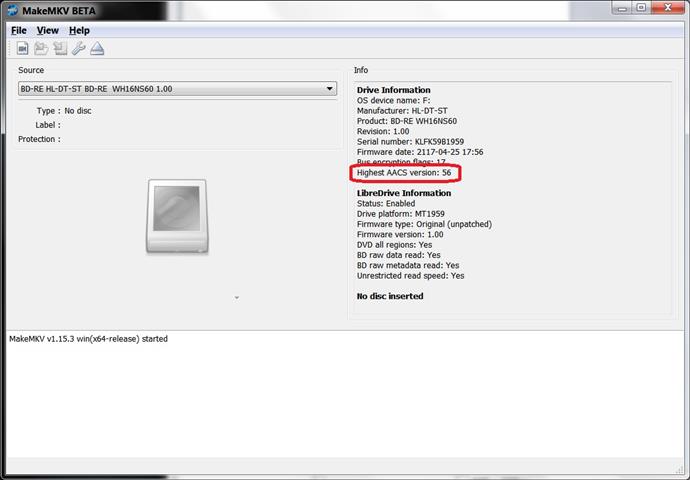

I believe "highest AACS version" is the highest version the drive has seen. It gets updated with new discs.
Posts: 1713
Re: same drive, different OS, different AACS support levels?
Post by d00zah »

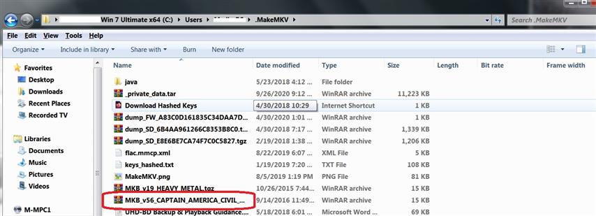

I believe "highest AACS version" is the highest version a MakeMKV user has seen.
MakeMKV (Small).jpg (31.05 KiB) Viewed 15662 times
MakeMKVDataDir (Small).jpg (47.32 KiB) Viewed 15662 times

The "highest seen" is stored on the local machine, not on the drive.
What the drive stores is the revocation information from a disk, and that is loaded before MakeMKV can actually see it.
Posts: 1713

But the drive has 'seen' several discs at AACS 62 on the windows host, shouldn't transfer to the OSX also show AACS 62?
Images above demonstrate that that data is stored at the PC user level, NOT by the drive. Even a different user on the same PC could see a different "highest AACS version" reported.
