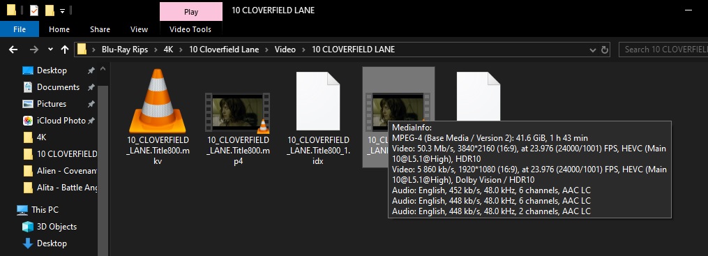

p.s. I checked out the mp4 and the audio was as you said in AAC and the Dolby Vision in another 1080P video within it.
Rip info
Rip info
Regards
Dave
