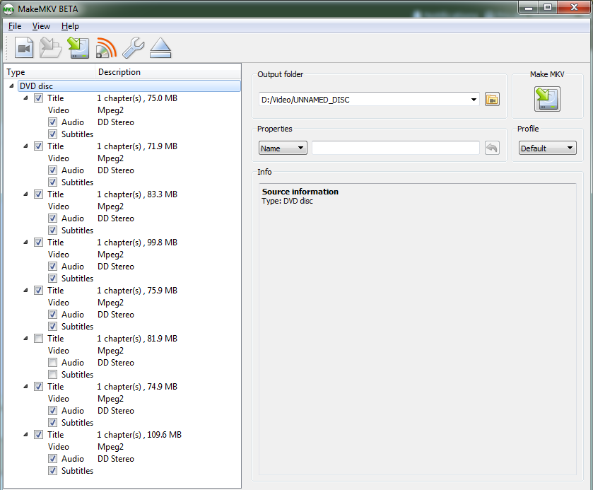

Dear MakeMKV team,
I have a DVD which MakeMKV recognizes as DVD with several independent chapters. However I would like to save them into one MKV file + have chapters automatically generated. How can I go this? Several forum threads (
one,
two,
three) suggest to use MKV tools to do this, which I use at the moment. However then I would need to create chapters file by hand. Can MakeMKV save all selected tracks to one MKV so one can skip manual "append" step? Can MakeMKV also generate chapters file automatically?
- screenshot.png (65.74 KiB) Viewed 19482 times
Re: Save selected tracks to one .mkv + generate chapters
Posted: Sun Aug 26, 2018 2:09 pm
by d00zah
Create the individual .mkvs with 'MakeMKV' & use 'mkvtoolnix' to join them into a single file.
Posted: Sun Aug 26, 2018 7:14 pm
by dma_k
@d00zah: I am pretty OK to use mkvtoolnix-gui.exe to append MKVs. However chapter generation does not happen magically. The GUI has chapter editor, but (as far as I know) it allows only manual creation/editing.
Posted: Sun Aug 26, 2018 8:01 pm
by mreedelp2
Use MKVToolNix GUI. Add the files to be appended together, but before creating the new file, select the Output tab. On the right side near the bottom there is selection for Generating Chapters. Click on it and choose "One chapter for each appended file". Then rip.
Posted: Sun Sep 02, 2018 10:10 pm
by mike admin
If your source is DVD then you actually can do it from MakeMKV using
http://www.makemkv.com/manualdvd/ . But mkvtoolnix is probably an easier choice.
