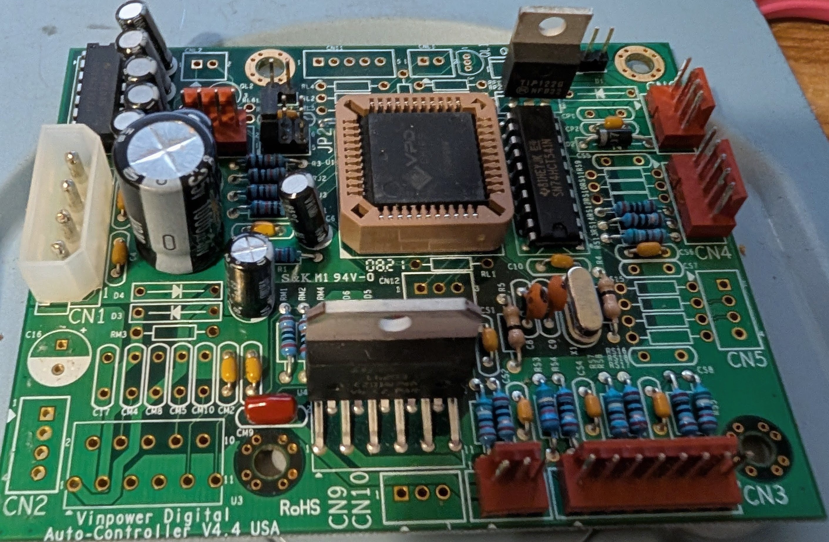

HiI purchased a CD DVD duplicator robot off of eBay and thought that I could upgrade it to use USB. but it has no usb. I started looking more into it after I got the unit. I found out that it does not support native USB. So I guess my real question is what parts do I need to make it work so that I can back up 5,000 discs? I like the technical skills to hack one. What I would like to do is take the unit cheaply swap the guts out for example upgrade kit from vinpowered digital and voila! It works with Windows so that way I can use makemkv, handbrake and IMG burn with it.

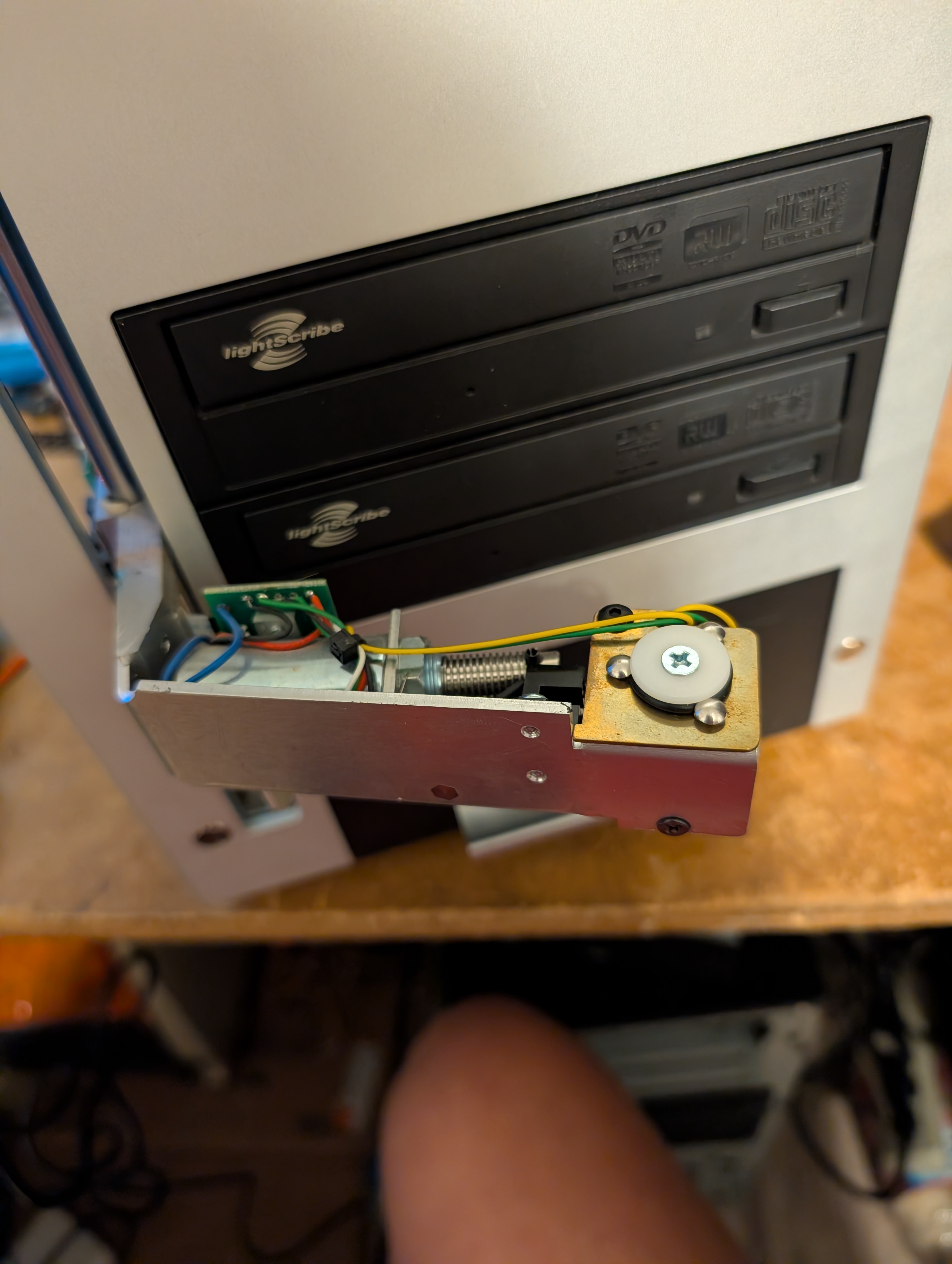

1. "reverse" engineering one of these models is probably not the correct term since it was probably not engineered to be A. controlled remotely B. it's only purpose is to copy the same disc over and over, so it could use fixed x,y cordinates and z's routine can be to raise completely then lower until the pickup tool registers a surface (usually with a feeler gauge and optocoupler)... in other words the arm may run completely without software.

Again, best bet is to attach a new switch for homing (or tap the existing one if it has one) and run your own controller. Typically the pickup tool works on a solenoid so you tap that too. This might sound hard, but it's rrrrrrreal easy, even for those with the smallest learning capabilities. Since it's that easy, it is recommended to start with a larger model like I linked to because no matter the size you'll almost certainly be modding the exact components with the same hardware you buy, so why not get the biggest possible?

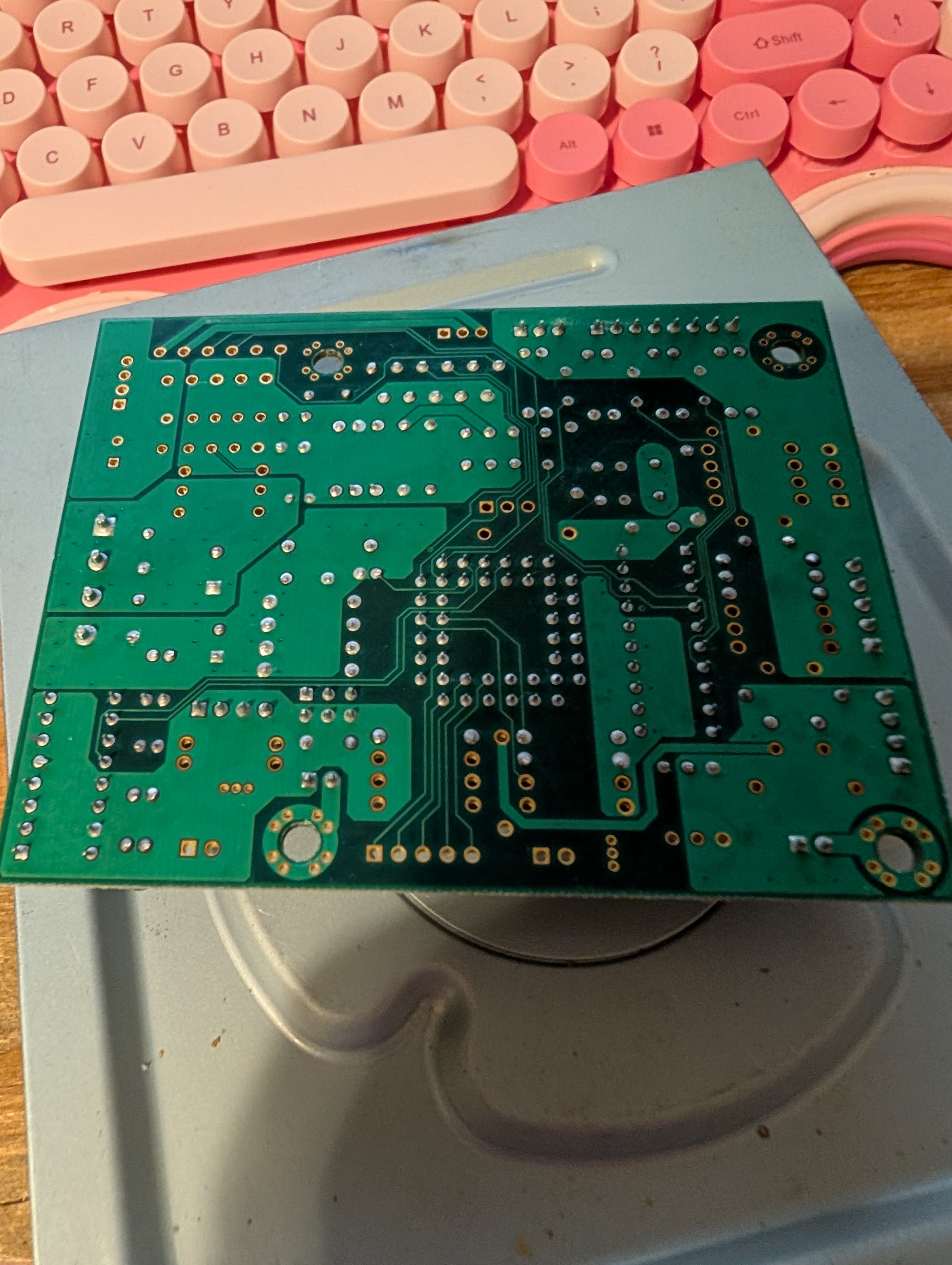

Because I already own the unit, it has a solenoid for a pickup. The only thing I need is to control the robot arm and solenoid. Coding is not the problem at the moment. It's just getting everything wired up correctly to a raspberry pi 3B+. I'll be replacing the drives with SATA drives and using USB to SATA interface and a hub windows will be doing all the ripping. I'll be using makemkv and handbrake to output to MP4. IMG burn to backup games in software. Then I will have it do smart renaming all wrapped up in a nice looking GUI. Is my starting point. I do not have electronic skills at the moment or programming so I'm relying on chatgpt for help. That may not be the best way to do it. That's the only way I know right now. Unless somebody wants to help me write the code and reverse engineer this I would appreciate it. I bought it on eBay thinking that it was SATA interface and thought you would be an easy project. Just added USB port somehow and be done. Sadly I was wrong. According to chatgpt it uses +,-,Rx,tx but I don't know which order it uses it in. I can't even find a manual. Vinpower suggested I upgrade to a ripbox and somebody could find me the parts. I'd be glad to throw them in my box and be done with this. The current interface is IDE. I have a Blu-ray sata drive and I have a stack of SATA drives so I'm good on drives other than needing one more Blu-ray drive. Thank you for your help and consideration in this matter.
