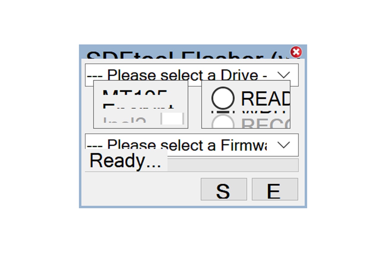

Has anyone experienced this?? This is what happens when I unpack it in my folder and open the control panel. I tried resizing my font... I tried grabbing the box edge and resizing it... no luck... I deleted and reloaded it several times... still the same result. I've never had this issue come up before... any help to resolve this would be welcome. Thanks Smedley

In the first post of the SDFtool Flasher thread, there a note that says the following:
NOTE: If the GUI looks a bit deformed (happens on a 4k monitor), you can right click the exe and select properties. In the compatibility tab, click "Change high DPI settings" then under "High DPI scaling override" tick the box and select "System (Enhanced)" in the dropbox.
