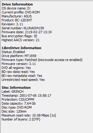

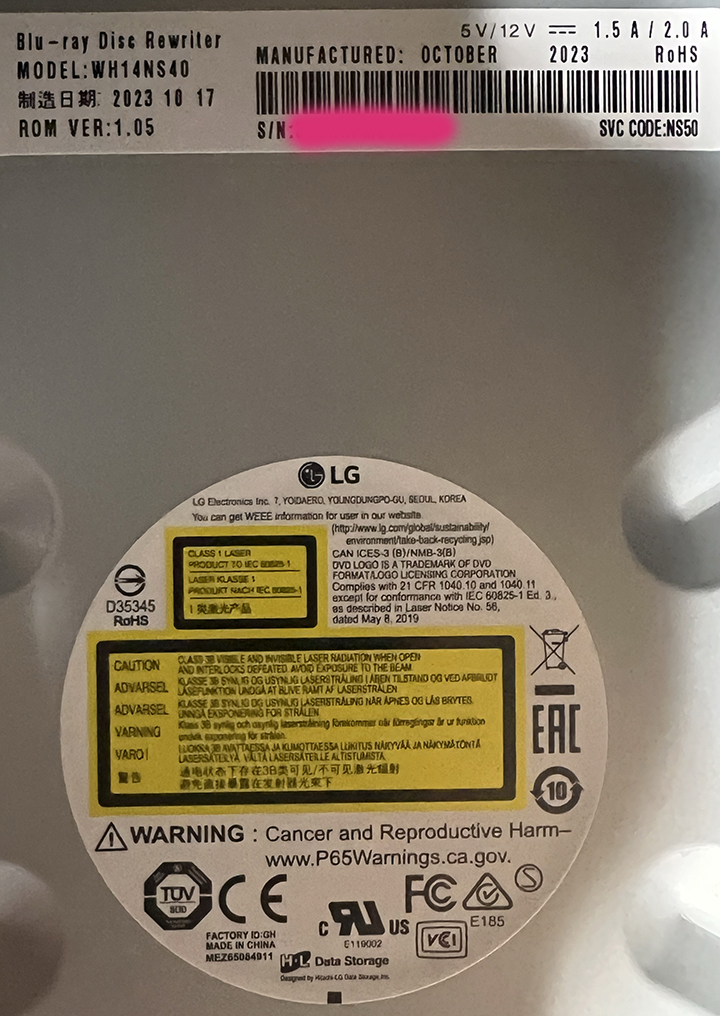

Well I figured out what is going on, I purchased and lg drive on Amazon that is listed in my first post. The drive says M-Disk LG and Blue Ray Disk on the drawer that opens up. All stickers on the drive say its an LG WH14NS40 drive.
But when checking the drive with MakeMKV it says that it is an ASUS Drive 12D2HT and it says that it has everything enabled for ripping, LibreDrive included..
I have encoded three disk so far with what seems as no problems..
This drive I think someone flashed and sent back to Amazon. See attached images.. Can this be flashed to the correct firmware or should I send the drive back and get another one.
