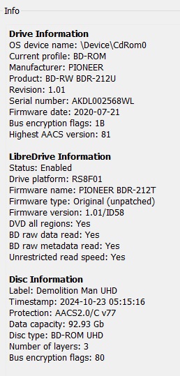

I've looked around a bit on this and I see when others have had the same issue, I guess I'm just not entirely sure what I can do, if anything, to fix it. My drive had been working fine, I've just recently ripped 4k discs of Signs & Deadpool/Wolverine, but I tried Demolition Man today and now I'm getting the "Can't read AACS VID from disc - most likely current AACS host certificate is revoked by your drive" error. Is there anything I can do? Thanks.

I've resolved other discs, I just needed to reset my PC and others are working as normal again.
But Demolition Man, I just can't get it to work. MakeMKV has all kinds of issues reading the disc period and if I use IMGBurn to create an iso, if I try to load that in MakeMKV I get the volume key unknown error. I've downloaded the most recent KEYDB, doesn't help any.

I had this exact same issue with the Arrow 4K UHD release of Demolition Man. I thought it was a bad disc at first, so I got a replacement. Same issue with the second disc, even after thorough cleaning with rubbing alcohol.
Drive information:
Lots of read errors to the point I get this:
This one stands out to me as a bit suspicious, given both pristine discs exhibit this behavior:
Attempting to retry I get realllly long decrypt times that seem to go on forever. I end up ejecting the disc and unplugging the drive.
Drive information:
Manufacturer: PIONEER
Product: BD-RW BDR-UD04
Revision: 1.14
Serial number: ...
Firmware date: 2020-06-15
Highest AACS version: 81
Drive platform: RS8A10
Firmware version: 1.14
Disc Information
Label: Demolition Man UHD
Timestamp: 2024-10-23 05:15:16
Protection: AACS2.0/C v77
Data capacity: 92.93 Gb
Disc type: BD-ROM UHD
Number of layers: 3
Bus encryption flags: 80
The source file '/BDMV/STREAM/00506.m2ts' is corrupt or invalid at offset 0-6144, attempting to work around
The source file '/BDMV/STREAM/00506.m2ts' is corrupt or invalid at offset 6144, attempting to work around
The source file '/BDMV/STREAM/00506.m2ts' is corrupt or invalid at offset 6144-12288, attempting to work around
The source file '/BDMV/STREAM/00506.m2ts' is corrupt or invalid at offset 12288, attempting to work around
...(these repeat a lot)
Too many AV synchronization issues in file '/BDMV/STREAM/00506.m2ts' (title #-) , future messages will be printed only to log file
Error 'Scsi error - MEDIUM ERROR:POSITIONING ERROR DETECTED BY READ OF MEDIUM' occurred while reading '/BDMV/STREAM/00508.m2ts' at offset '0'
Using LibreDrive mode (v01.0 id=489CDFD6D392)
Using direct disc access mode
Error 'Scsi error - MEDIUM ERROR:POSITIONING ERROR DETECTED BY READ OF MEDIUM' occurred while reading 'BD-RE PIONEER BD-RW BDR-UD04 1.14 DEDL136811WL' at offset '66465955840'
Failed to load content hash table, unable to verify integrity of M2TS files.
