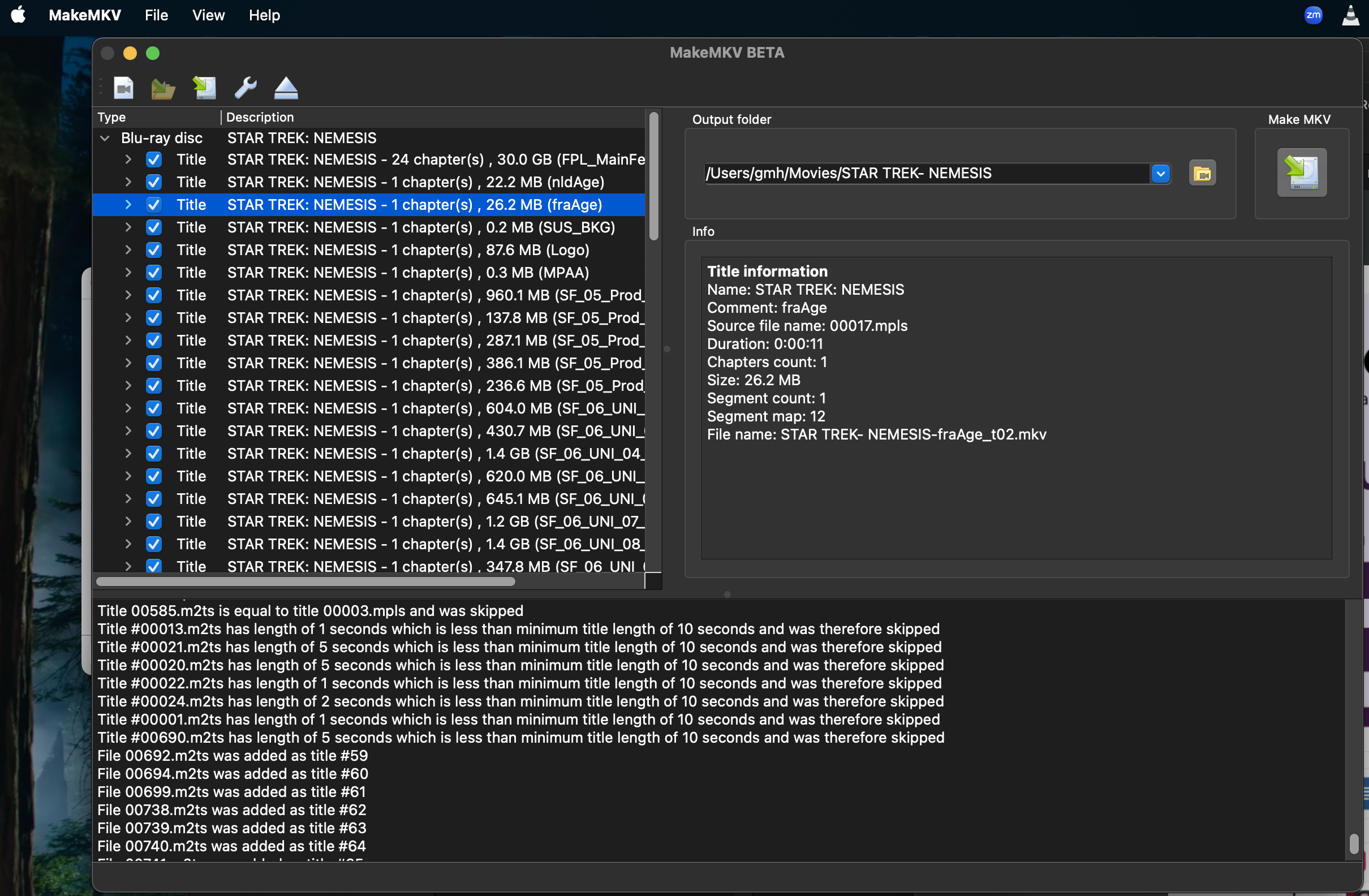

Post by psycoperl » Sat Dec 07, 2024 12:58 am
Where do you see the option?
For example, in the screenshot above, I would like to change the name to be more descriptive that would work with PLEX. Many of the disks I have just get named {Disk Name}_tXX.mkv where XX is a serial number for the tracks.
Screenshot 2024-12-06 at 19.58.12.png (120.71 KiB) Viewed 2689 times
Screenshot 2024-12-06 at 19.55.30.png (1.21 MiB) Viewed 2689 times
Posts: 10865
Re: MakeMKV - Before Ripping Specify File Names
Post by Woodstock » Sat Dec 07, 2024 1:09 am
Ah... Go to Properties->General, and click on "Expert Mode" to turn it on, then OK.
THEN you'll see the Properties sub-menu on the main screen. I've used Expert mode for soooooo long that I forget what it enables.
