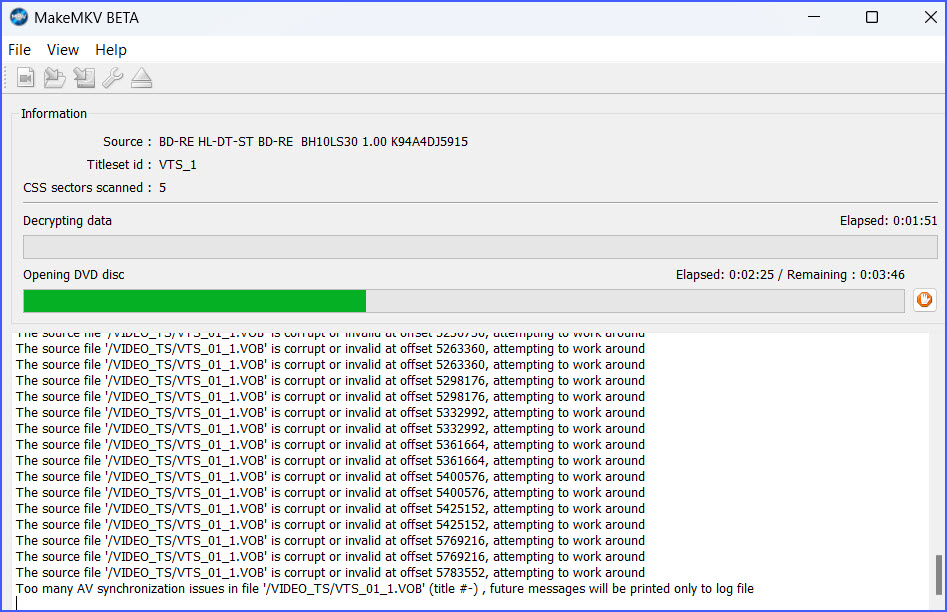

I'm having issue now though. I have been using the Beta for about month with no issues at all. Then I was just about to purchase a full license, but as I went to launch MakeMKV to purchase it said license expired. No problem, down load and re-install.
BUT that didn't work, said license expired. I can't find it now but somewhere on this site it shows the beta license key as valid until August 31st 2024. It hinted at changing the PC system date to launch. That works, but now EVERY dvd I try to rip ends in failure. I get multiple lines of errors ( screenshot attached ).
I have tried to rip about 15 dvds with no success. But I can rip using another product ( no names, but I think MakeMKV says it makes corrupt VOBs or something
I really want to purchase this product, but now I'm feeling a little bit worried it might not work.
- MakeMKV.jpg (290.99 KiB) Viewed 5351 times
Re: issue with ripping.
FAQ about BETA and PERMANENT keys.Bigwozza wrote: ↑Tue Sep 10, 2024 2:33 amI'm glad it is ripping for you.
Thanks, It seems the winding the clock back to start MakeMKV does work, but the ripping then doesn't work ( for some unknown reason ). I have now tried it with the new temp key ( until the end of Oct 2024) and it all work fine.
So now I WILL buy the permanent key
