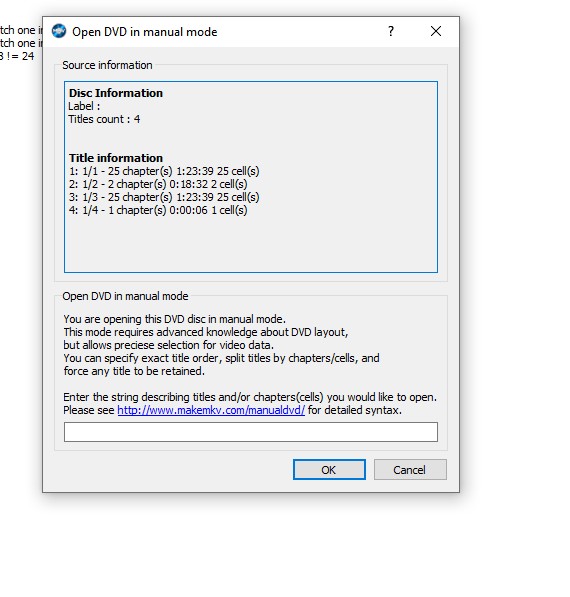

Request help with manual mode syntax. I am using registered version of V1167 with the dvd title attached below. I am not getting a correct rip just doing how I normally do ie clicking on the drive within MakeMKV. I wanted to try manual mode, but wanted to ask how to write the syntax for 1/1 should be 25 chapters, then 1/2 just two chapter and 1/3 25 chapters and 4 1 chapter. So 4 files. May I please ask the community to please suggested the correct syntax I would enter under manual mode to create this please? Thanks

You want all the chapters for each of the 4 titles? Then just listing the title numbers will do it:
1 2 3 4
You might also experiment with Preferences -> Protection -> DVD structure protection removal method. Some new options were added recently.
