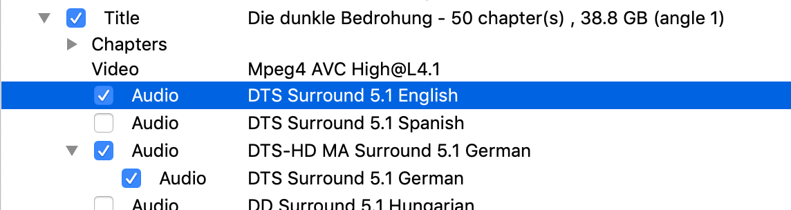

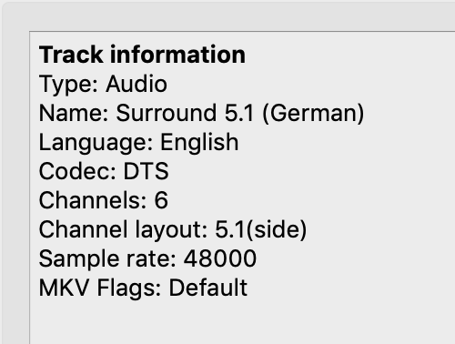

However, in MakeMKV v1.16.5 (and older versions) the main title's first audio track only shows as a single DTS 5.1 track:
MakeMKV screenshot 1
MakeMKV screenshot 2
And after letting MakeMKV mux the MKV from the backup files, mediainfo also only reports "6 channels":

Is MakeMKV only showing and muxing the 5.1 core of the DTS ES XXCH 6.1 track and ffmpeg/ffprobe is just wrongly detecting "6.1" in the MKV?

  • Some software like MakeMKV, mediainfo, mkvinfo and mkvpropedit just either don't handle 6.1 that well, or — what I believe — MakeMKV incorrectly adds 6 as the number of channels in some metadata while muxing which is why these other programs report "6 channels" on the MKV.
