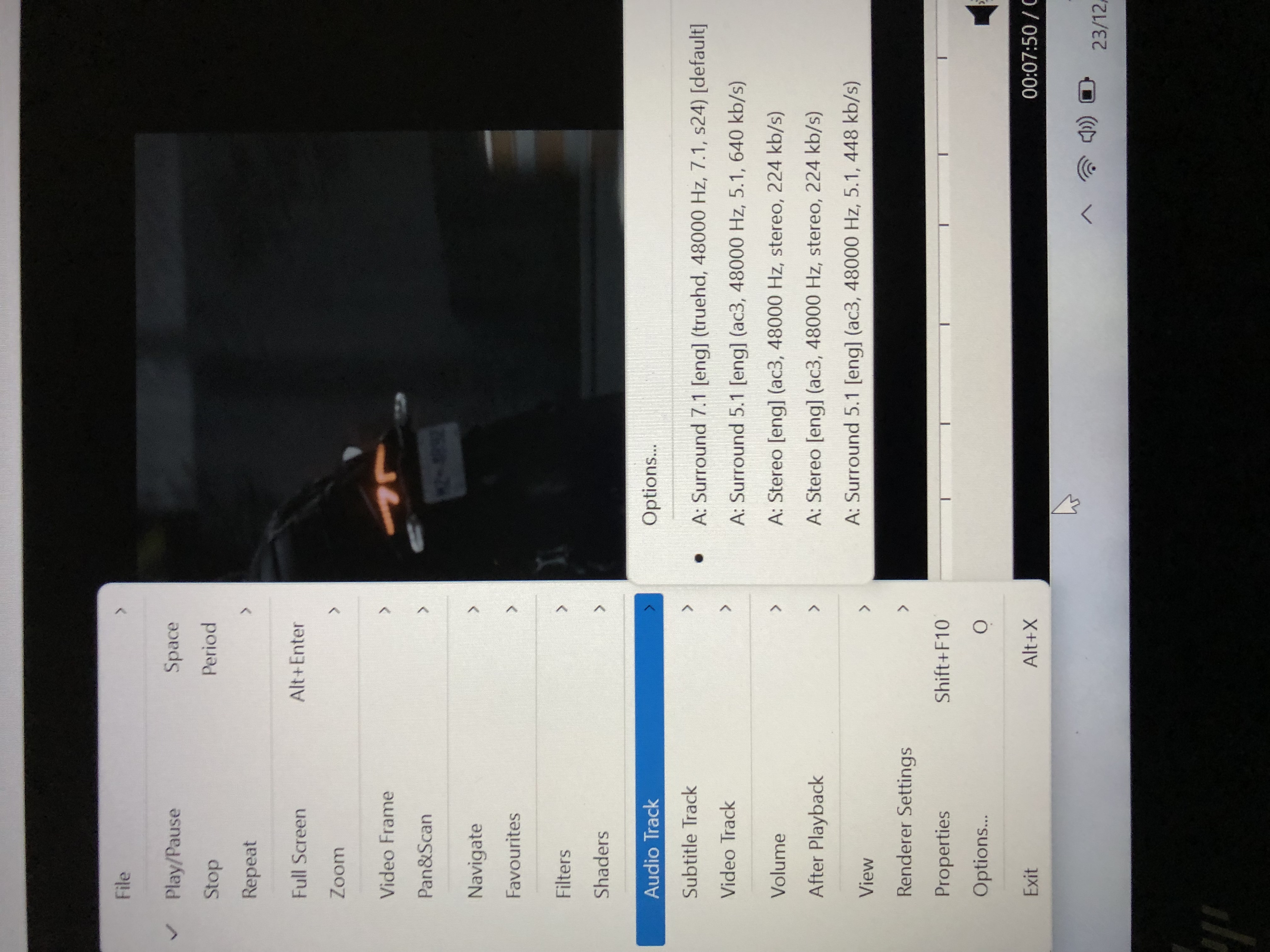

Can someone please confirm how an Atmos track should appear on a ripped UHD -MKV
( ie when I select audio options, I see the options in the pic, I was expecting 1 of the options to be labelled as Atmos? / or is it the one labelled truehd 7.1 .s24? )
Cheers for any info.

Yes true hd is Atmos
And dts ma is dtsx
Make sure you set your player to bit stream the lossless audio to your avr if you have one
