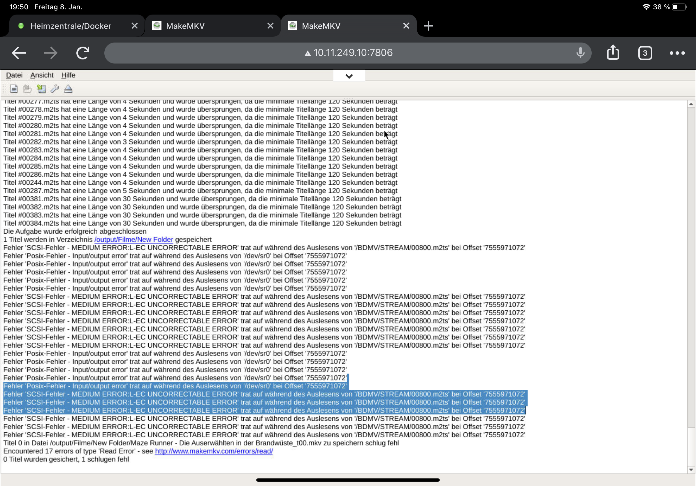

Maze Runner: The Scorch Trials (Blu-ray): I get the following messages (Screenshot). The disc is flawless, there are no scratches.
The Rip Errors FAQ: viewtopic.php?f=8&t=15055
Those errors indicate that the optical drive was unable to correctly read the disc. Even if the disc looks flawless and even if it plays in a blu-ray player. MakeMKV is trying to make a perfect copy of the bits on the disc.
