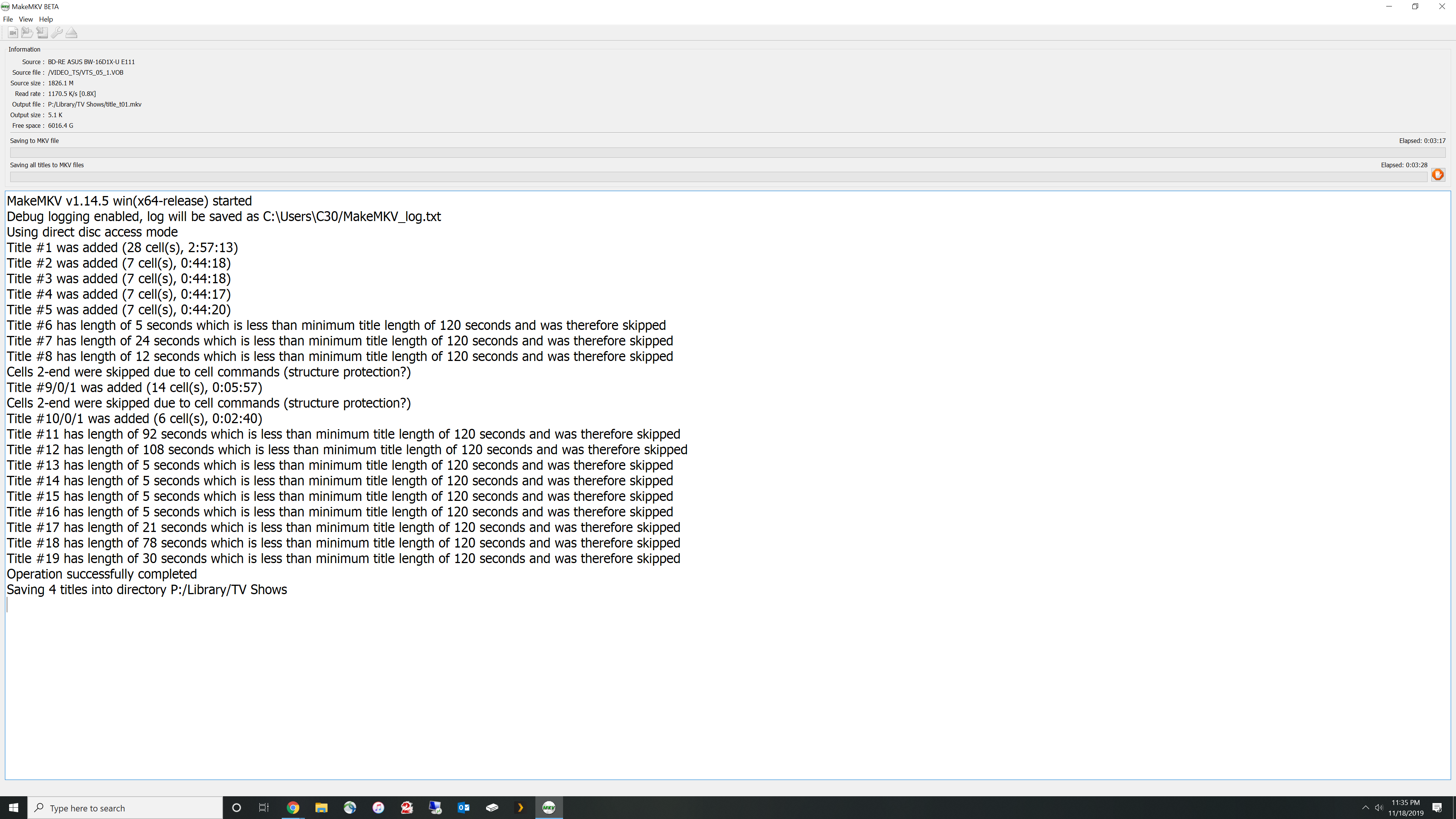

I've been using MakeMKV for last year and a half and this is the first time I'm running into reading problems.
Summary of problem:
1. The MakeMKV program and disc reader appear to have no problem identifying the titles on the discs.
2. Once download of selected titles starts, the drive speeds up to 2x-4x reading speed. However there is no progress bar indicator.
3. The read speed then slows down to .7x about a minute and a half into the download and stays there for the duration. Once a title incredibly near completion the progress bar becomes active for a few seconds and shoots up to a quarter completion (if I was downloading 4 titles from the disc).
4. Ultimately the program finishes (however this is now taking hours instead of minutes as it was before).
Specs:
Windows 10: 64-bit
i7 processor, 16gb ram
ASUS BW-16D1X-U
MakeMKV v1.14.5
Solutions tried:
1. Uninstalling the drive/reader from device manager
2. Checking driver updates
3. Uninstalling and reinstalling MakeMKV
4. Installing previous version of MakeMKV
Help me fix my slow read speeds! No progress bar
- Slow MakeMKV.png (372.7 KiB) Viewed 6729 times
