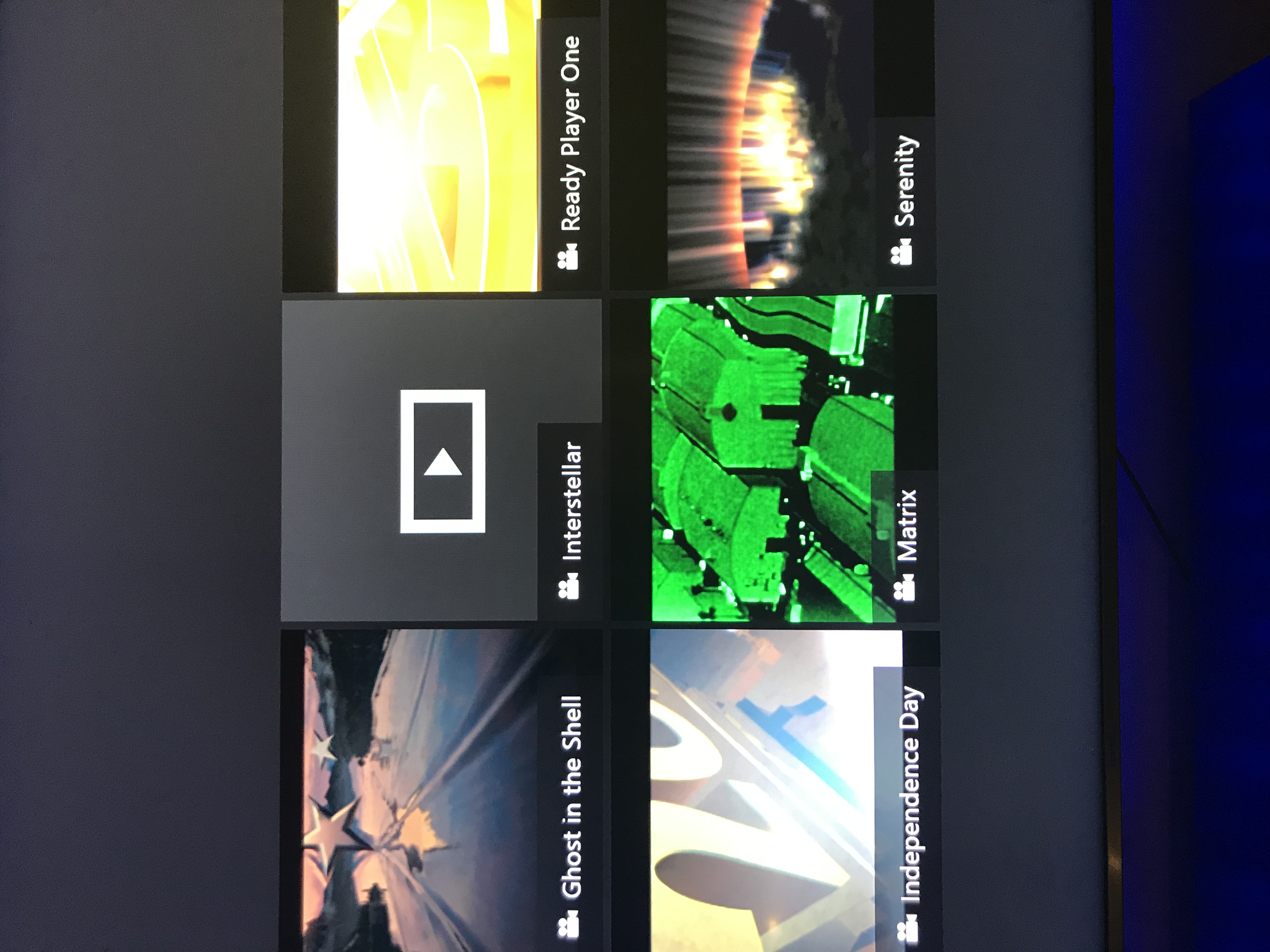

Ever since flashing my drive, I am having all sorts of issues. I never had a single problem before and now nothing that I do results in files I can view on the XBox (fine on PC)
I just tried Intersteller and I get the message’VLC is unable to open MRL ‘file......’
I feel like whatever happened with that firmware really seriously messed up my drive. I know I’m not giving much but I had a perfect drive that I then flashed so I could save a few UHD titles but since then nothing works.
It almost looks like the file format is different. Before the firmware all of the files appeared as film previews now they all are generic Play icons..
