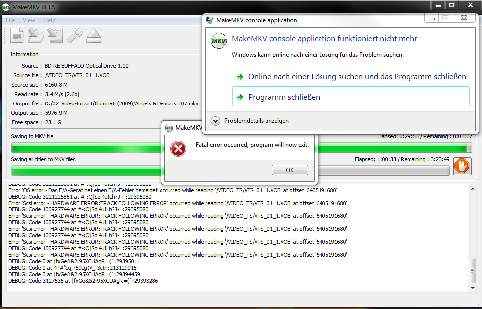

since i have done the update to 1.14.3 win x64 release.
i can't copy Movie DVD (2) and BlueRay (1) too.
i go until around 60% then it say something about scsi error or something like that.

Re: software crash around 60% and close
it is on a win7 Computer and attached a printscreen of the error befor it goes
- problems.PNG (114.07 KiB) Viewed 8875 times
Given the type drive (USB connected, powered by USB), the type of error (drive says it can't seek to the next point in the file), and the errors after it, the best guess is, "You do not have enough power available for the drive to go at full speed". It's been a long time since I saw that reported for a DVD, though.002003:0000 Error 'Scsi error - HARDWARE ERROR:TRACK FOLLOWING ERROR' occurred while reading '/VIDEO_TS/VTS_01_1.VOB' at offset '6405191680'
When the drive spins faster during a rip, it uses more power. When it hits the limit of power available from the USB port, it goes off-line, and the operating system can get very confused about that. And confused operating systems can send confusing data to programs.
Make sure the drive is plugged into a USB port that has full power available to it. Usually an on-board USB port, or a hub that has its own power supply to make full power available.
Some Lionsgate DVDs will have fake titles that send the drive to illegal locations, but this is a Columbia Pictures disk.
