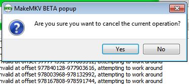

If MakeMKV encounters errors due to radial scratches it can take hours to get past a [tiny] faulty area. When you don't have the time for this, you click the Stop button, but very annoyingly MakeMKV just ignores it and keeps rollin' along... The only way to stop it is to eject the disc.
Would it be possible to PLEASE have MakeMKV stop right away. To my mind, "Stop" should stop it instantly.
Can't quit processing of faulty DVDs
- It just won't stop, no matter how many times you click it!
- MakeMKV_error.jpg (27.5 KiB) Viewed 10493 times

The stop command has to wait until the part of MakeMKV that is actually talking to the drive "gets talkative" again. If it is waiting for the drive to respond to its last request, it will be "stuck" until the command times out. And that comes down to what the hardware is doing.
With the new drives I put in to handle UHD, I've started to see times when Windows thinks the drive is off-line (and it tells MakeMKV that), when the drive is simply trying REALLY HARD to read a sector.
If things are working fine with the drive, the stop signal seems to be acknowledged very quickly.

I'm having a problem with a particular track on a particular disc. Make MKV can't stop when it is waiting for the drive, BUT, the same disc in the same drive using DVDFab fails in the same area and does stop within a second when told to cancel. Just saying. If they can do it so should MakeMKV imho.
