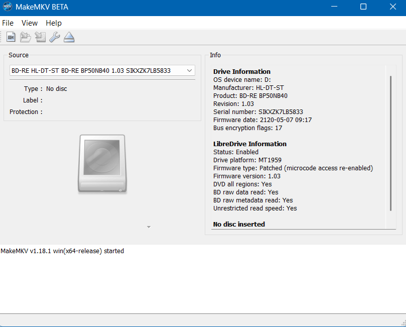

I'm very new to MakeMKV and BD ripping. However, I have ripped hundreds of DVD discs with Handbrake. I have flashed my LG Bluray slim drive (model WP50NB40 Svc code NB50) I have spent hours on here and am completely stuck. First off, I have attached a snapshot of MakeMKV so you can review how the drive is seen in the program. I have also enabled "Enable Internet Access" When I put a bluray disc in the drive, it spins up but does not recognize ANY bluray disc. It says "no disc detected" Secondly, I am not getting any .tgz files being created. I am assuming that is because no disc is being detected and therefor no .tgz file. One step at a time I suppose. I'll deal with the HASHES later.

I don't think you've flashed your drive to the correct end state for ripping.
The Ultimate UHD Drives Flashing Guide, in the 'Recommended Firmware to flash for MakeMKV' section says: BP50NB40 to > BP50NB40-NB50-1.03MK then to > BP60NB10 1.02MK or 1.00MK
It seems you're half-way done with flashing.
