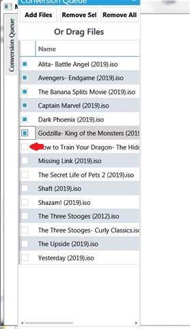

After you drag/drop the folder, did you 'mark' titles in the list to add to the process queue? Seems to work for me??
QueueSel (Small).jpg (37.16 KiB) Viewed 13016 times

d00zah wrote: Fri Nov 26, 2021 2:46 pm After you drag/drop the folder, did you 'mark' titles in the list to add to the process queue? Seems to work for me??
Basically what I do is add the folders to the queue and then sort out what I'm keeping and what I'm getting rid of and then when I'm finished I tick the first file and that starts converting and then I tick the rest of the files so their ready to remux.
