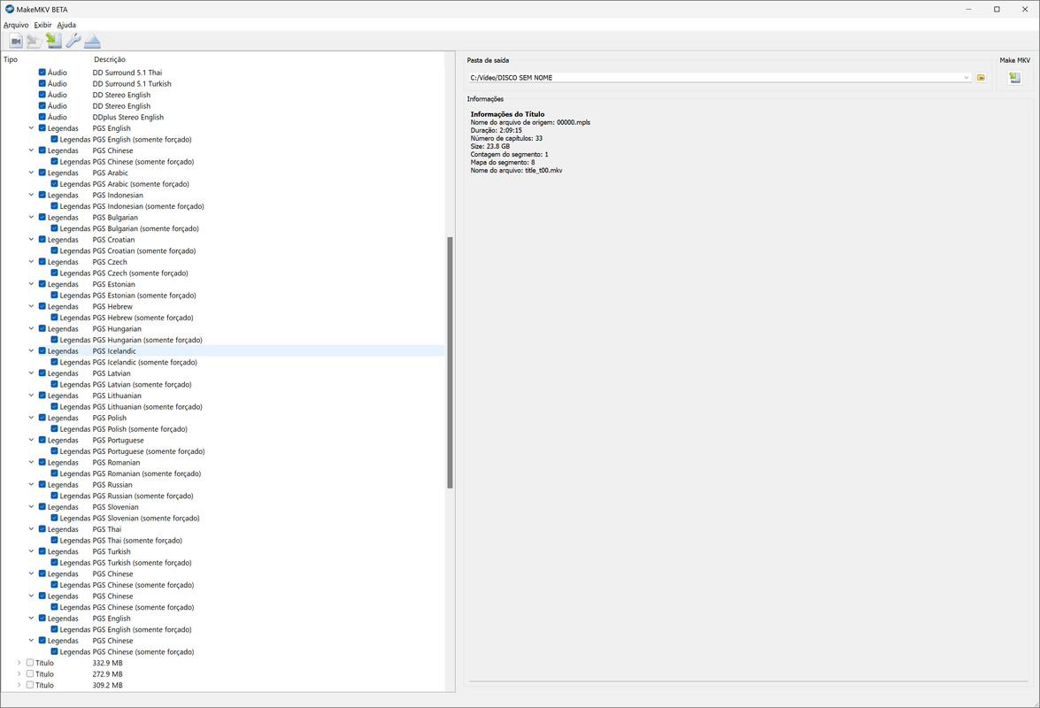

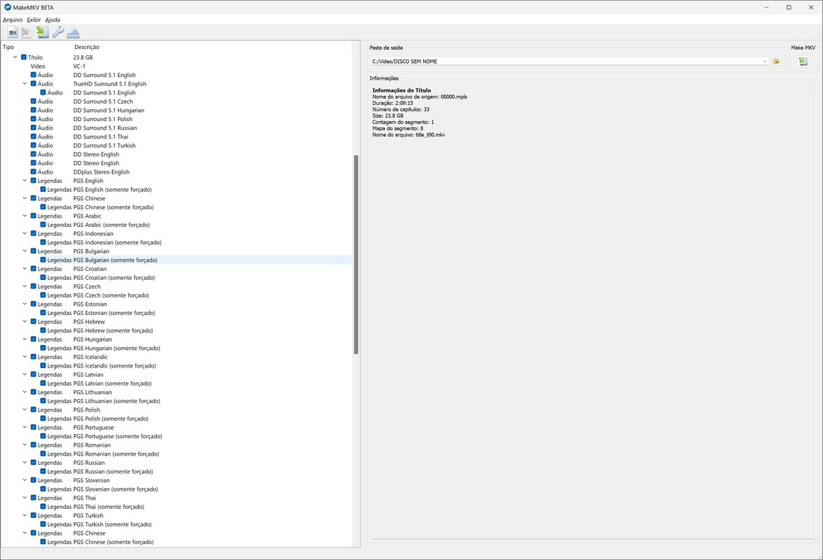

But today I ripped the old edition from MATRIX REVOLUTIONS (2003), Blu-ray. And to my surprise, this is what I saw. I am unchecking all extra content and only showing the title related to the MOVIE itself.
https://i.postimg.cc/Znz7Hhyg/PIC1.jpg
First thing we notice is that chapters are missing from the repeated stream. This is what the 1st one looks like:
https://i.postimg.cc/xjLFCqwS/PIC2.jpg
At first, I would only rip with the first two commentaries. And nothing else.
Oddly when I looked into the repeated #2 title, this is what I found (check the two pictures):
https://i.postimg.cc/x8GsFFvd/PIC3.jpg
https://i.postimg.cc/qM0DC4r6/PIC4.jpg
So, not only 1) and 2) are there, 3) it is, as well! But 3) is missing from the 1st title!
Not only that, in PIC 4 we discover 3) also is available as english subtitles.
