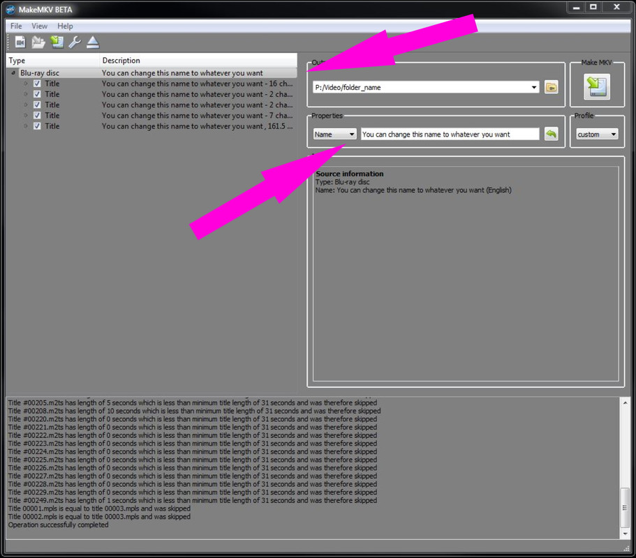

You can change the name of the disc to whatever you want.
After opening the disc, click on the top row in the left pane (highlighted by default unless you click somewhere else), then type whatever name you want in the text box in the properties pane...
I typically remove any and all text from this box every time I open a disc because it makes it easier when pasting track names.
Ah, the reason I wasn't aware of said feature was due to it being an "Expert" option.

My apologies, it's been so long since I setup MakeMKV that I had forgotten that some may not be in "Expert mode" (Preferences > General tab).
