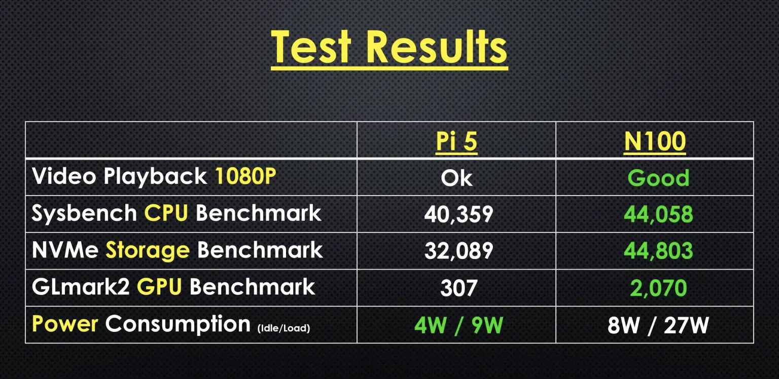

That is not the whole story in terms of power consumption differences:
So it can be up to 18W under load and in my use case probably 10-12W most of the time.
But either way these are not massive differences.

Actually after doing calculations 12W more (estimated for my use case, where 18W more is the max) for N100 equates to about 32 euro per year more in electricity cost where I live.
That makes a difference as over few years CM5 cost of hardware goes to zero vs more power hungry N100 and as I don't really need extra power of N100 (which is anyway mostly in GPU area according to tests) then I think I will stick with CM5 idea and see how it goes.
