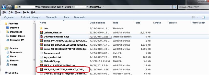

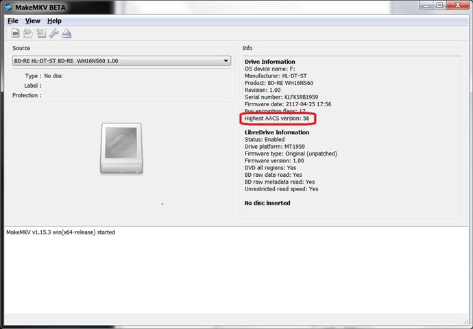

I believe "highest AACS version" is the highest version a MakeMKV user has seen.
MakeMKV (Small).jpg (31.05 KiB) Viewed 14157 times
MakeMKVDataDir (Small).jpg (47.32 KiB) Viewed 14157 times

Images above demonstrate that that data is stored at the PC user level, NOT by the drive. Even a different user on the same PC could see a different "highest AACS version" reported.
