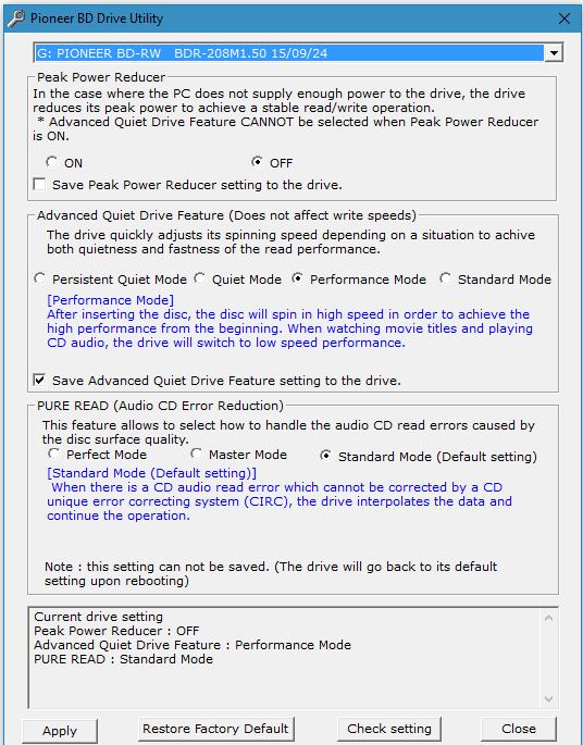

Pioneer drives can slip into "quiet mode" that speed-limits them to about 2X when reading video. It's supposed to keep the drive quiet when playing movies. It can be turned off, but it shouldn't turn itself back on for only certain disks...
That makes sense. When I installed the latest firmware I ran a utility that was supposed to disable that mode.
Exiting the program and going back in seems to reset the mode to performance mode.
Maybe my utility is obsolete? Got a link to one that works?

I re-ran the utility, and it is set to performance mode. See my attachment.
When I sought a firmware update, I think I ended up on Pioneer Japan's site. I had version 1.20 or something at the time, Japan's site had 1.50. I downloaded the drive utility from the same site.
Pionnner USA has firmware for the BDR-208M, but Japan had one for the BDR-2208. When I did some research, the extra 2 was inserted for a retail box, the drive would be the same drive otherwise. I did take precautions such as backing up the firmware just in case, but the flasher saw the drive and was happy with what it saw, and the drive still reads 208 as it is supposed to. So I have to wonder if something in the software isn't triggering quiet mode.
I will do some more experimenting when I go from disc to disc. Maybe there's something in there I can reproduce the issue with. (Usually I swap discs, and as the tray is closing, I hit the OK prompt on MakeMKV that it completed the previous disc. The screen animation updates that the tray on the drive is closing. Maybe I should try pressing OK before even ejecting the current complete disc, then insert a new one)
pioneer drive mode.jpg (97.53 KiB) Viewed 14009 times
