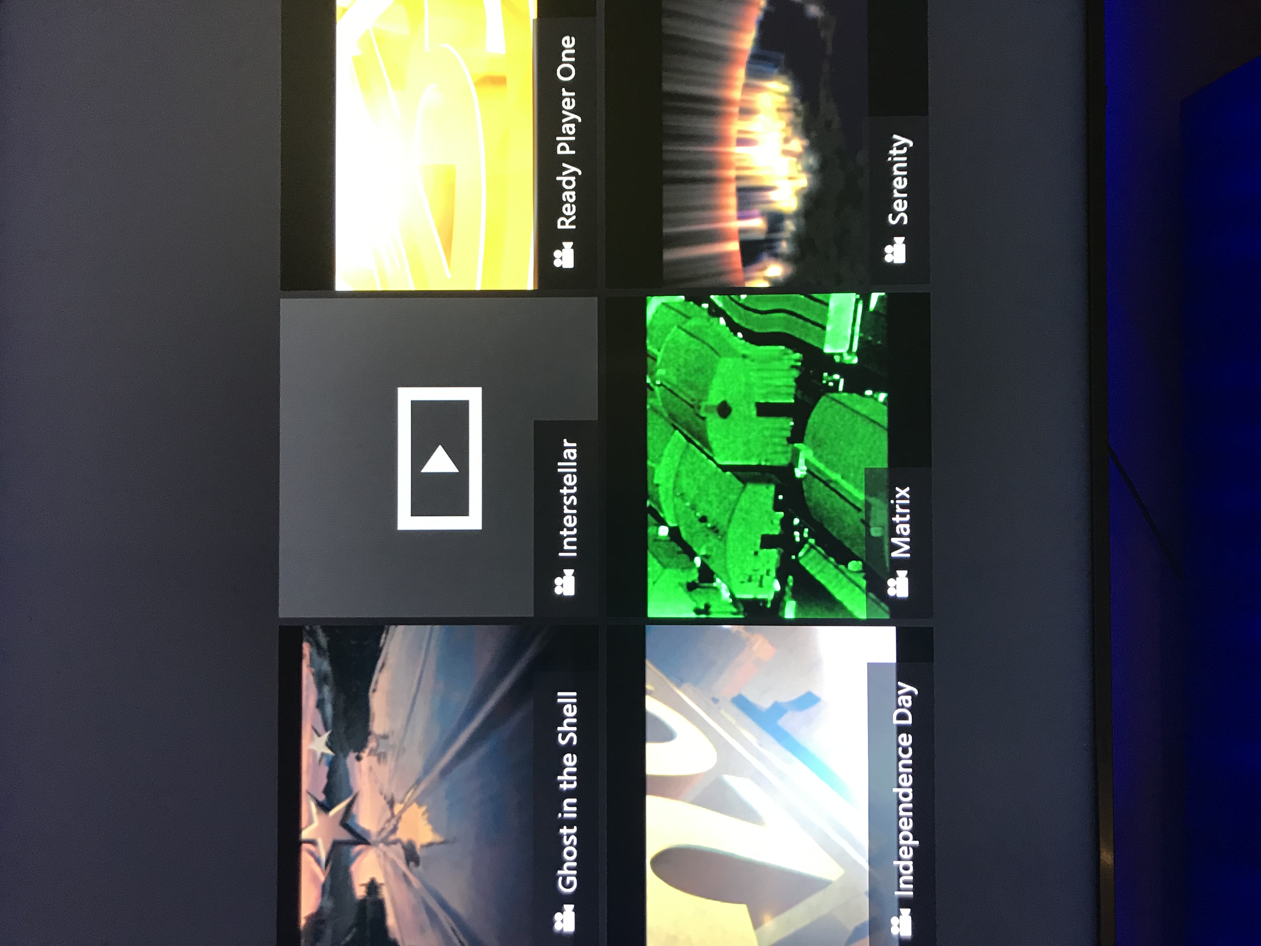

Also, within Media Player the file icons aren't even the same as the other files. Instead of a screenshot of from the beginning of the movie all of the effected files just have a 'Play' icon.

I feel like whatever happened with that firmware really seriously messed up my drive. I know I’m not giving much but I had a perfect drive that I then flashed so I could save a few UHD titles but since then nothing works.
It almost looks like the file format is different. Before the firmware all of the files appeared as film previews now they all are generic Play icons..
