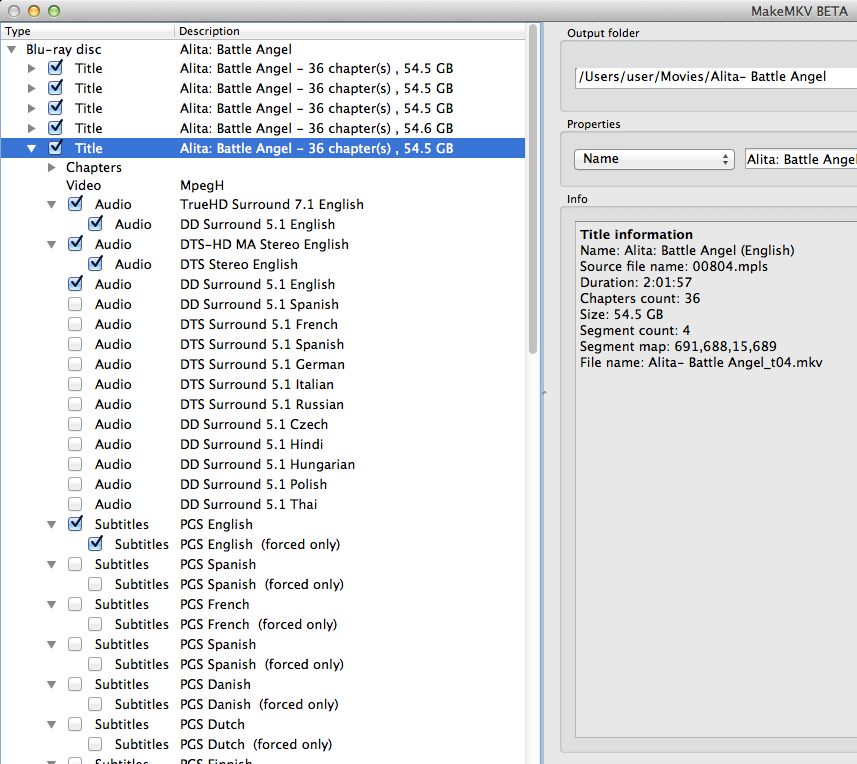

I recently remuxed a UHD Blu-ray, using MakeMKV 1.14.4, that had 9 titles, all the appropriate size and duration. I had never done this before so I needed to know how to choose the best title. I found this forum thread that helped me decide––Determining correct title on BD with MULTIPLE titles. I copied and pasted the 'Segment map:' line for each title to a text file.
Segment map: 687,688,674,689
Segment map: 692,688,18,689
Segment map: 6,688,21,689
Segment map: 691,688,15,689
Segment map: 4,688,674,689
Segment map: 690,688,17,689
Segment map: 694,688,19,689
Segment map: 693,688,674,689
I played the corresponding m2ts files from the Blu-ray's BDMV/STREAM directory to see what they contained.
For example, for the first title, which corresponds to 00800.mpls, I played 00687.m2ts, 00688.m2ts, 00674.m2ts, and 00689.m2ts. I saw that segments 688 and 689 were common to all titles. 00688.m2ts contained the whole movie, minus the intro and outro, and 00689.m2ts contained the end credits in English. The other two files contained the different language versions of the intro and outro. Both titles one and two referred to the same segments, which were for the English version. The only way I knew that was by playing 00687.m2ts and 00689.m2ts and seeing the English wording. Corresponding segments from other titles were for different languages. I was surprised that only the English audio and subtitles were chosen by the app for each title. Maybe there was no further information available to determine the language?
