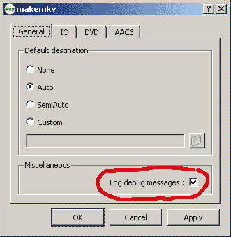

Please see the log window (the lower part of the program screen) for more details - it should specify exact cause of failure.

mike admin wrote:Please see the log window (the lower part of the program screen) for more details - it should specify exact cause of failure.
It does not specify anything of the sort, the window is blank.
Have you actually tried this program on any BD/HD DVD discs ? If so, which ones worked, I'd like to duplicate that if possible.
