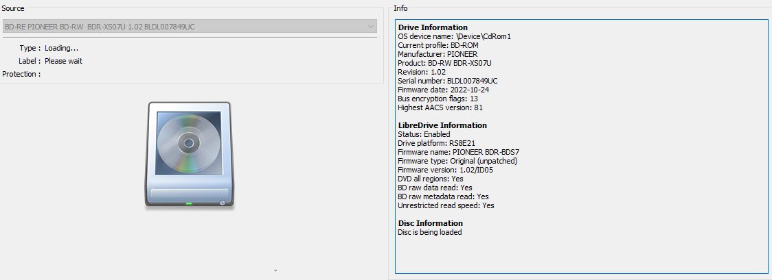

I am lost on how to get this to work. I cannot get Demolition Man 4K to open in MakeMKV. I have gone back and tried other disc (4K and Bluray) and they open just fine. Windows reads the disc, but MakeMKV hangs at the attached screen. Any ideas??

I think this is an issue with the Pioneer drive. I have the same issue with my Pioneer, but it seems to work with my Asus BW-16D1HT on 3.10 firmware, I'm ripping it now (switching between 3.10 and 3.03 solves read errors I may encounter). I was reading some where on here people saying Pioneer drives just struggle with UHD some times.

I don't think its a power issue. I'm using the vantec enclosures that is recommended by everyone here. I also bought a new one to try it and its still the same issue, Pioneer cant read the disc. That doesn't make sense to me, why would Demolition man need more power when every other UHD disc rips fine? I've also seen a few posts about this and everyone that has an issue reading this disc has a Pioneer drive. It worked fine copying with my Asus and I watched it last night on my DuneHD, worked great. I also doubt my drive is failing, its rather new and has never had any other issues or signs of failing.

I have the same issue with a Pioneer BDR-XS07U and an LG WH16NS60 in an OWC Mercury Pro enclosure.
With the LG drive, MakeMKV gets stuck during the decryption stage (no errors thrown, but the progress bar never completes) whereas with the Pioneer the progress bar remains blank after kicking off a disc backup (no errors thrown on screen). Even after ripping 2000+ discs (UHD and HD), I have never seen this behavior before. I put in another 4K disc to make sure the drives didn't get borked but whatever is going on seems specific to this disc.

I was finally able to backup the disc with my Pioneer drive. At my wit's end, I figured I try to copy the entire disc to an ISO using dd which to my surprise, completed without a hitch. Immediately after, I fired up MakeMKV and I was able to backup the disc. I don't know if the dd copy somehow made the MakeMKV disc backup possible but that's the sequence of events that finally worked for me when all prior attempts failed. YMMV
P.S. This was all done on a Mac with MakeMKV 1.17.8.
