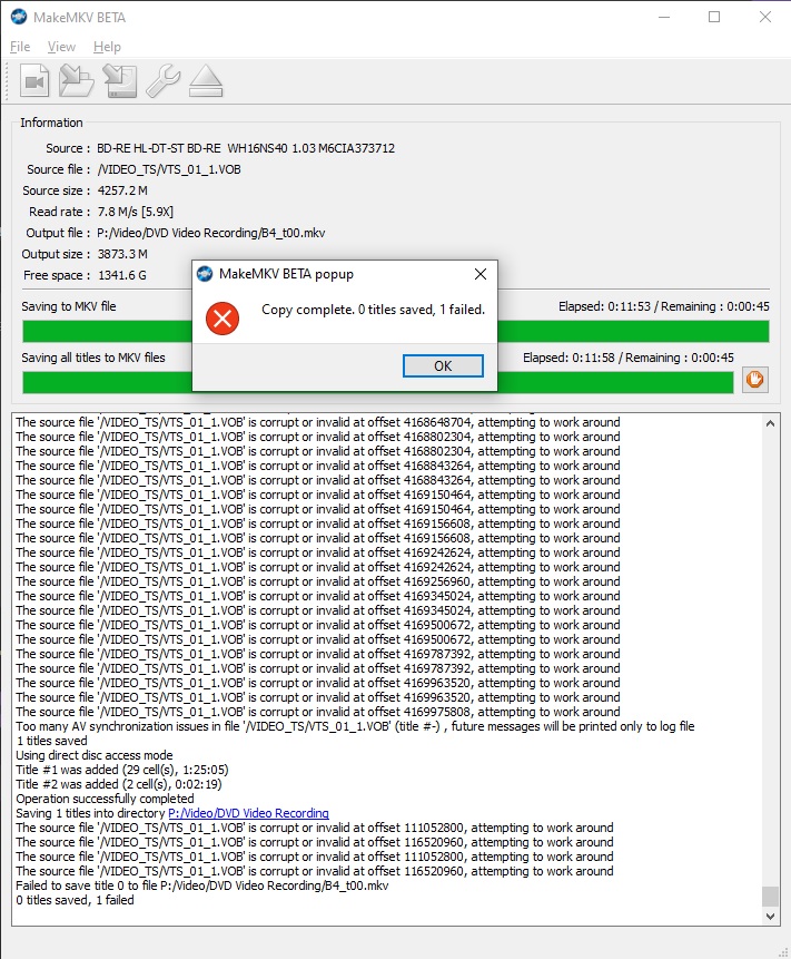

I attached a screenshot of one.
- Error
- Error.jpg (288.9 KiB) Viewed 4596 times
Re: Errors on all attempts
So the disk contains a lot of errors. It managed to work around a lot of them, but it stopped when it couldn't.
Cleaning the disk will probably help, but there is no guarantee. MakeMKV will only save a file if it can read the whole thing.

So you can confirm the problem is the disc? Like I said I have had around 10 discs all fail consecutively, even ones that were previously successfully ripped.
The most likely scenario is a failed disk. It is possible that the drive has simply died, but unlikely.
A full reset (as in powering the drive down and back on) will sometimes help, but that would be unusual when it's finding PARTS of the disk readable, even when they take a few times to get a successful read.
