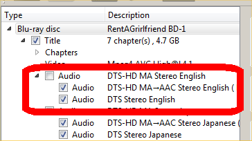

You can play with the capabilities within MakeMKV by making sure you have Expert Mode enabled, and selecting either the FLAC or AAC profiles on the advanced tab that will appear. This is how the available selections change when using the "aac-stereo" profile, for example:
In this case, it can convert an DTS-HD MA into an AAC stereo track. The original DTS-HD MA track is also available to be selected.

Re: MakeMKV and Stereo Audio
In the example, the original audio is the DTS-HD MA track; the indented options are derivations from it. The --> indicates a conversion, while the "DTS Stereo" is the base lossy core.
MakeMKV defaults to extracting "lossy core" audio from lossless audio tracks, for compatibility. For TrueHD, it will pull out the AC3 core by default.

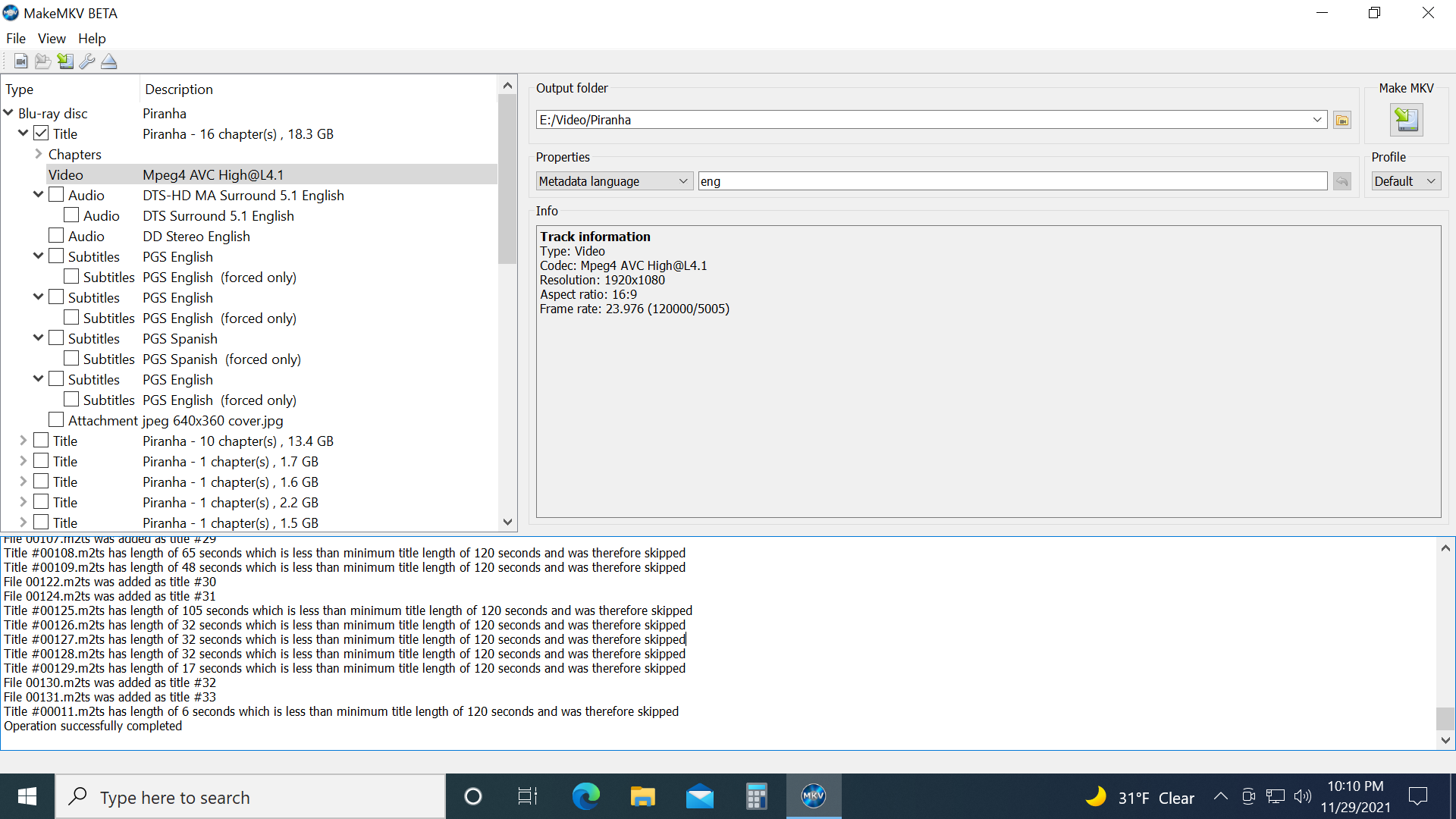

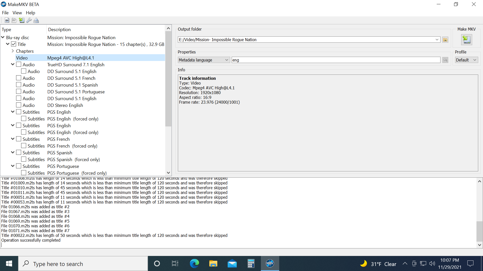

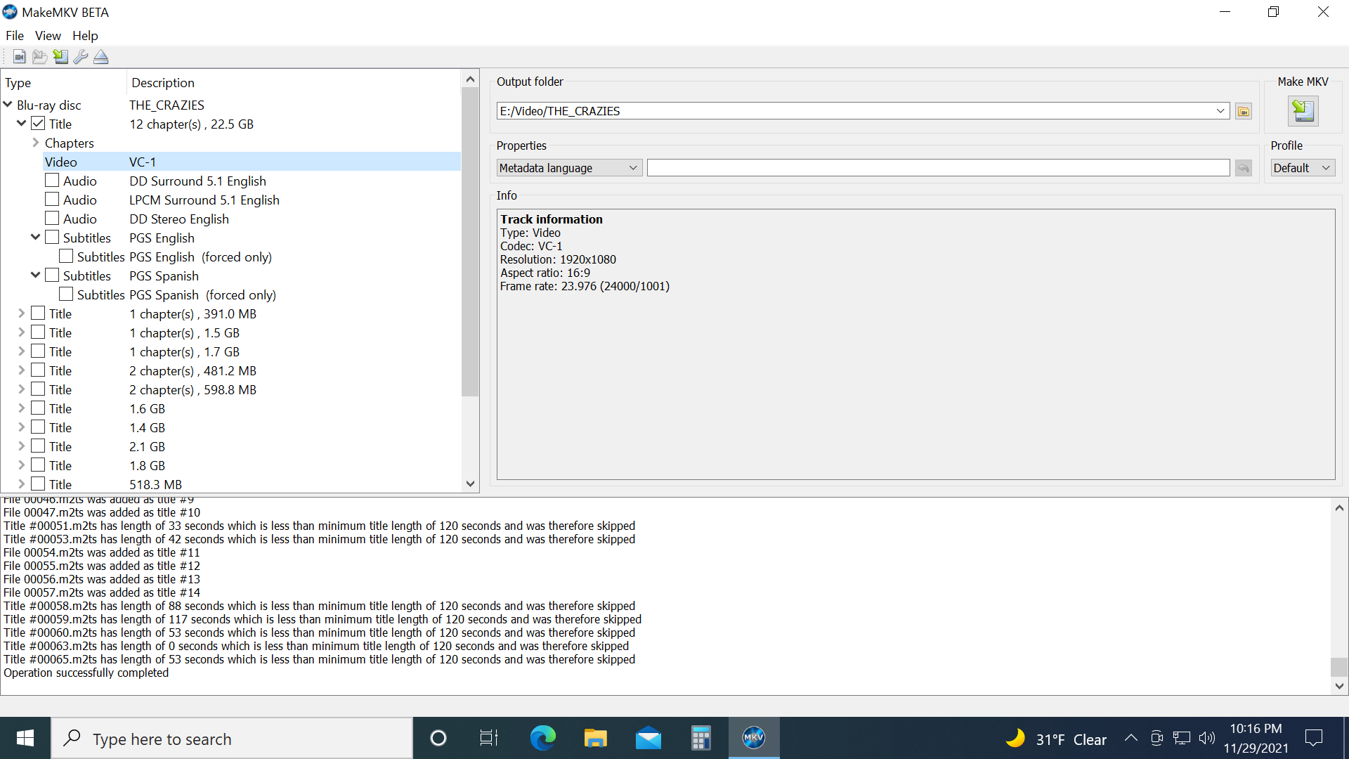

Here are the examples,
- Piranha.png (165.47 KiB) Viewed 7749 times
- MI.png (163.69 KiB) Viewed 7749 times
- crazy.png (159 KiB) Viewed 7749 times
In all of those cases, your selected profile was "default", which will not offer conversions to other formats.
If you select "flac", you will get options to convert each track to FLAC, as well as saving the original. The "aac-stereo" profile will offer a conversion to AAC, as in my example above.
